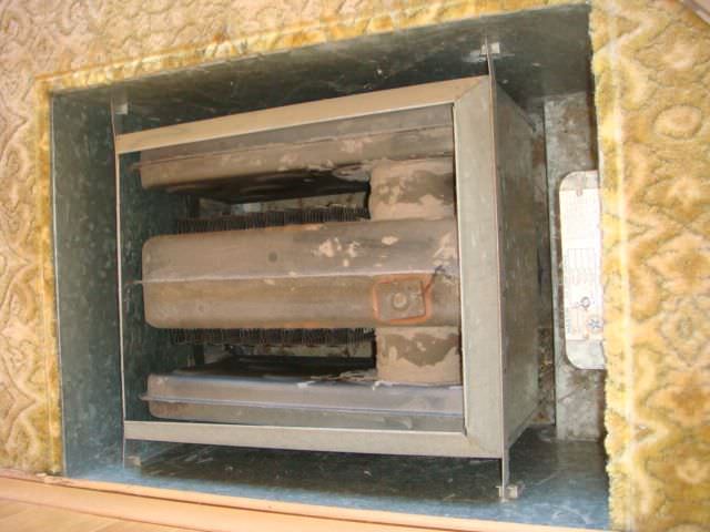

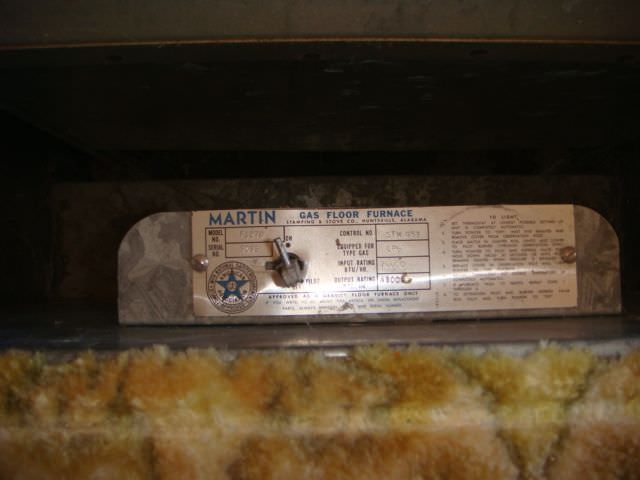

mridgeelk Posted August 20, 2009 Report Posted August 20, 2009 This furnace is the first one of this type I have seen. It is likely 44 years old and has had furnace cement applied to it in several locations. I recommended that it be removed or replaced due to age. I could not find any specific warnings or recalls regarding this model, does anybody know of any? Thanks. Click to Enlarge 33.57 KB Click to Enlarge 54.28 KB Click to Enlarge 38.48 KB

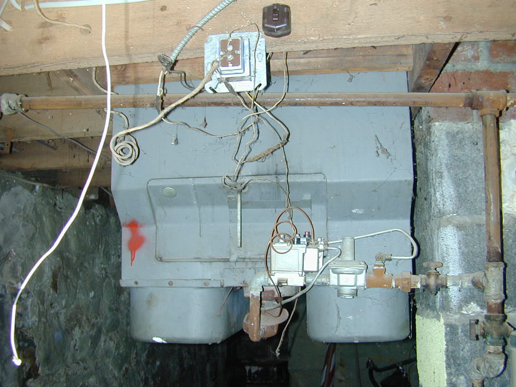

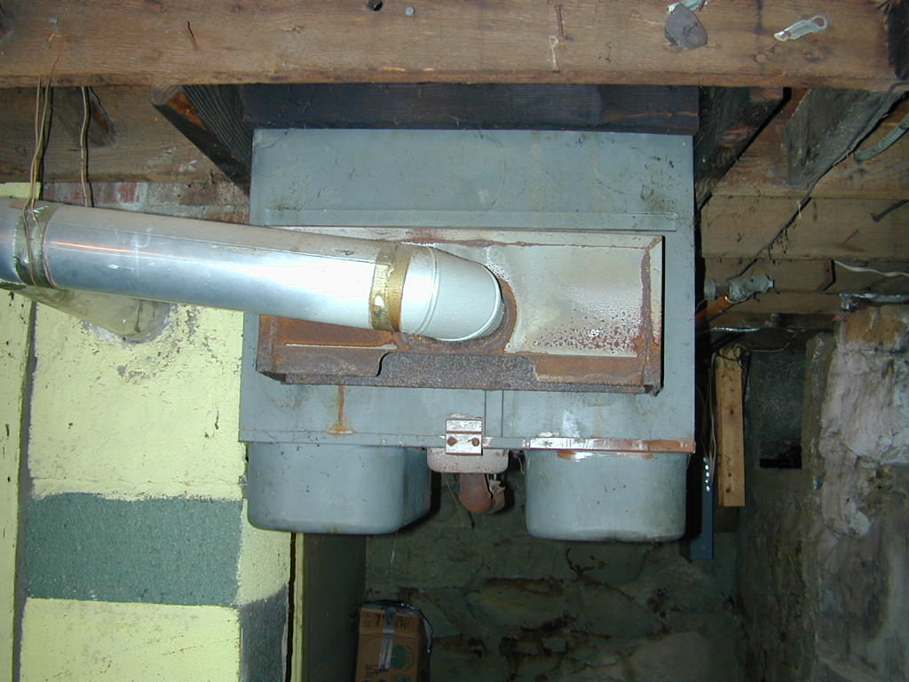

kurt Posted August 20, 2009 Report Posted August 20, 2009 Cool. So, that can just sits there in the floor and heat convects upward, right? How's it vent?
Kyle Kubs Posted August 20, 2009 Report Posted August 20, 2009 kurt said: Cool. So, that can just sits there in the floor and heat convects upward, right? How's it vent? Some of them didn't! [:-bigeyes Ed, it looks like where all that refractory cement is applied was probably to seal all the cracks/rot/separations in the heat exchanger, it's right where the welds would typically give way. Those things remind me of Grandma's house in the country in PA. And hers had Army guys too.[:-slaphap
Kyle Kubs Posted August 20, 2009 Report Posted August 20, 2009 Here's a couple pics of the last one I saw, a few years back now, that shows the venting. Download Attachment: 009.jpg 188.05 KB Download Attachment: 010.jpg 172.39 KB
mridgeelk Posted August 20, 2009 Author Report Posted August 20, 2009 It is vented through 4" B-vent into a CMU chimney. Quote Originally posted by kurt Cool. So, that can just sits there in the floor and heat convects upward, right? How's it vent?
Tom Raymond Posted August 20, 2009 Report Posted August 20, 2009 Both of the units above are very clean installs too. Most of the ones I see end up hacked through the main beam, with out any extra posts, and there are never any doublers on the floor joists. Tom
