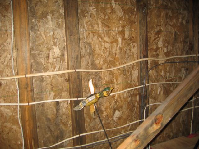

JeremyDP Posted August 10, 2009 Report Posted August 10, 2009 Yesterday I inspected a house that had a full bathroom in the garage. This bathroom contains a small electric water heater just for it (and the sink on the other side of the wall, still in the garage), a water softener for the entire house, and a well water tank and pump that feeds the water softener. The well water pump and lines to and from have condensation dripping from them. And the room is not conditioned. This bathroom is rarely used and the door is kept closed. Two of the walls are concrete, one of which is common to the lower level of the house. This common wall is filled with black spots, there is exposed framing that does not have any of these black spots. How do I know if this is mold? Click to Enlarge 44.13 KB Oddly enough in the attic with the same common wall to the house, it is darkened. Again, neighboring materials are not affected. And there are no signs of water intrusion in the attic. Click to Enlarge 60.73 KB If the water lines are wrapped, will this eliminate the condensation on them? Can anyone point me in the right direction? Or to some reading? Thanks!

waynesoper Posted August 11, 2009 Report Posted August 11, 2009 Looks like mildew stains from high moisture off the well tank. Mildew is mold. Was the well tank single wall or double.
Mike Lamb Posted August 11, 2009 Report Posted August 11, 2009 "Can anyone point me in the right direction? Or to some reading? Thanks! Jeremy P." Is it mold? Jeremy, among other things, read this. It's entitled, "Mold Testing," but it's not about testing at all. It's about testing being a waste of time and money. http://www.buildingscience.com/document ... hterm=mold Also read the other mold related articles Building Science has. If you have not already, read what the EPA and CDC says. http://www.cdc.gov/mold/dampness_facts.htm http://www.epa.gov/mold/moldguide.html Yes, there is mold on the walls. I currently report it as, "It looks like mold is on the ... Mold is caused by trapped moisture and I think the cause of this is ... ... I think ... ...should be done to correct this problem. Consult the EPA re: any mold clean up." The mold scare still exists and consumers (and lawyers, REAs, almost everyone) still don't get it.
JeremyDP Posted August 11, 2009 Author Report Posted August 11, 2009 Thank you Mike! And thank you for report instructions too! I have not yet read your links, but is it normal for this to be on the concrete wall, but knot the bare studs? Is this possibly mold in the attic too?
JeremyDP Posted August 11, 2009 Author Report Posted August 11, 2009 Looks like mildew stains from high moisture off the well tank. Mildew is mold. Was the well tank single wall or double. Thank you for the info. I was thinking that it might be mildew. I am not sure if the well wall is single or double. I'm assuming that it's single with the amount of condesate. The tank is at eye level so I did not look inside. By the sounds of it, I should have. I will definitely need to read up on well water and their tanks. This was only my second inspection (first house). My first inspection was a condo. Once I'm finished with the report, I plan to post it for critique.
CaoimhÃn P. Connell Posted August 13, 2009 Report Posted August 13, 2009 Good morning, Jeremy: As far as the concrete wall goes, I really canââ¬â¢t tell from the photo. However, assuming that it was mould (which is highly unlikely), then it would be inconsequential. Regarding your second photo ââ¬â the photo is perfectly clear to demonstrate there is NO mould problem. As far as ââ¬Åtestingââ¬
hausdok Posted August 13, 2009 Report Posted August 13, 2009 It might be some kind of form oil residue that's organic and is discoloring. I'd have them clean the concrete wall with a diluted (1:20) muriatic acid/water solution, neutralize it with TSP, rinse it down with water and then I'd wait to see if the spots reappear. ONE TEAM - ONE FIGHT!!! Mike
