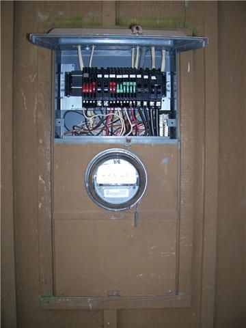

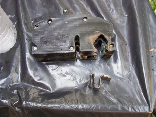

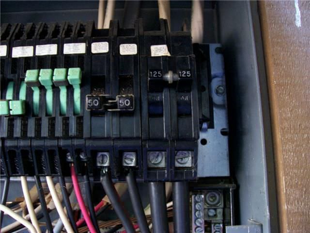

The attached pictures are from a repair we just did (we are getting him a price to replace the service). If you look at the first two pictures you see what the breaker looks like on a visual inspection. Then the last picture shows what the 125-amp breaker actually looks like!
There are several issues with Zinsco/Sylvania:
1. The first one is this is the reason I recommend a licensed electrician look at every Zinsco/Sylvania panel. You just cannot visually tell that there may be a major problem with them. It is very dangerous to remove a breaker in these panels especially since many of them (this one included) do not have a main breaker.
2. The second issue is that these panels are junk and are by far the highest number of panel problems that we find (followed by ITE, Murray, FPE, and older Siemens).
3. The last reason is that the breakers are very unreliable. I have seen 20-amp breakers with continuous 30-amp loads on them without tripping more than once. We have seen many examples over the years where Zinsco/Sylvania breakers are overloaded and did not trip.
