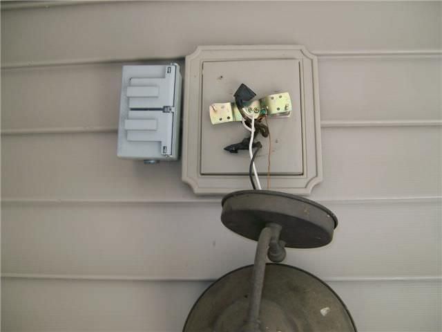

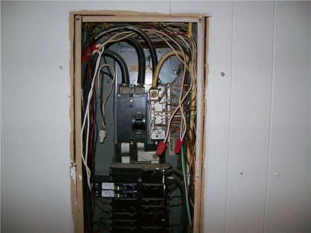

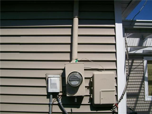

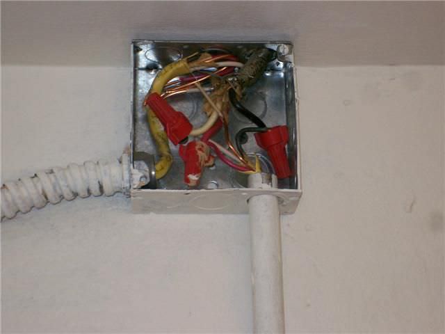

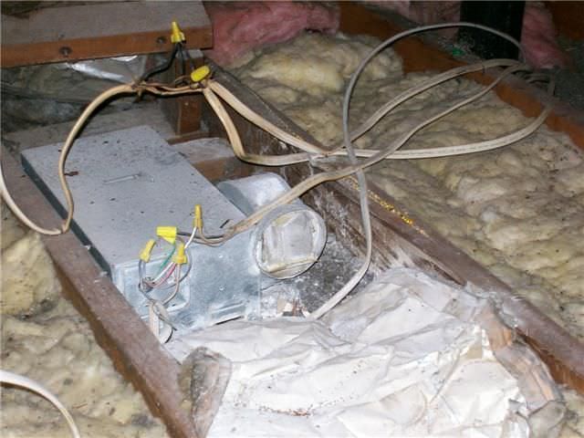

Mr. Electric says:

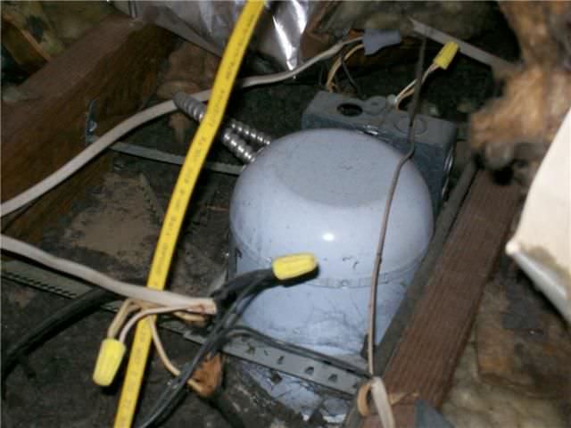

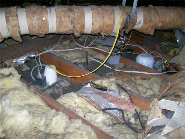

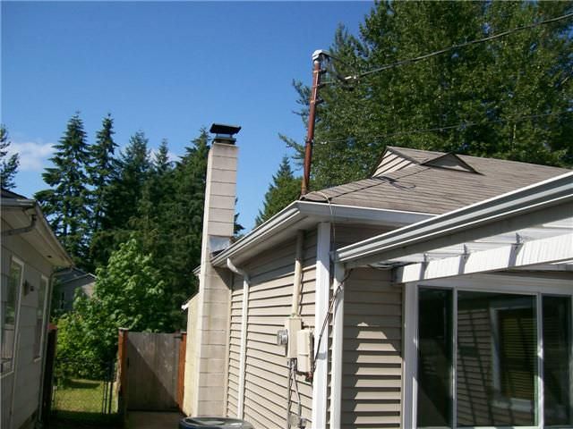

This is a job I was inspecting recently. When home owners and siding installers get involved, it doesn't get much worse (see meter base and mast). Then they have GFCI breakers in the panel that won't test (because the neutrals do not connect to anything), then the double tapped neutral, then the dryer wire is splices to #12 wire (30 amp circuit), then the attic at the cans and fan they added. Anyone say fire!!!
How about homeowner insurance - would they want this fixed???
Anyone see a need for electrical inspections when a home is sold????
Enjoy (the best way to view them is to download to a file then view).

Let me guess,
They had new siding installed and the siding guy did the removal and installation of of the meter, network interface and the exterior lights and outlets.
After seeing what a great job they did, the HO have them install the recess lighting.
Can't tell but it looks like they used the neutral for the hot and the hot for the neutral
Have a great day
Tim
Posted
Glad you are enjoying the pictures. I think the scary issues above were done by the siding people (Mast - Meterbase) and the rest was probably done by the homeowner or "a friend". If you as a home inspector find any electrical issues, I highly recommend that the home buyer hire an electrical expert to do an inspection. I am not trying to say that some of you cannot do one properly, but the big difference is an electrical contractor can spend an hour or even two looking at just the electrical issues. On this one I spent about 2 hours on site, you just can't dedicate that kind of time to the electrical system.

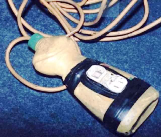

Hello Jim:
Great pictures of hazards you found! I am sure that your dad would agree! How is he doing? Say hello to him for me.
Click to Enlarge
61.03 KBThis is my favorite classic electrical code violation?
