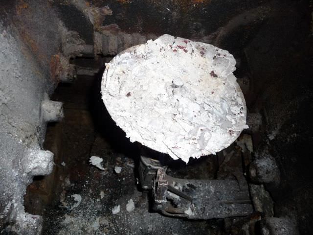

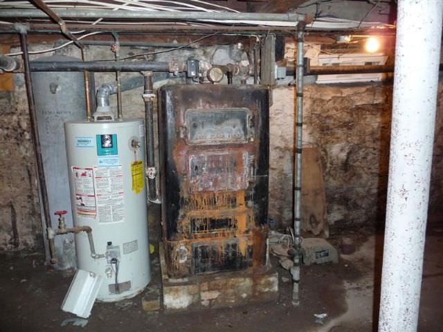

gtblum Posted July 19, 2009 Report Posted July 19, 2009 I was handed a discloser statement yesterday with a line that read, "boiler certified by XYZ boiler co." Still not sure what it meant. What do you guys think? It never did fire up. Click to Enlarge 59.23 KBClick to Enlarge Click to Enlarge 68.12 KB Click to Enlarge 59.85 KB
Inspectorjoe Posted July 19, 2009 Report Posted July 19, 2009 gtblum said: I was handed a discloser statement yesterday with a line that read, "boiler certified by XYZ boiler co." Still not sure what it meant. What do you guys think? Certified when? 1924?? Quote It never did fire up. Maybe that was a good thing. I just hate it when the weekend starts off with a trip to the emergency room. It looks like you must have had a real fun time on that one. I love the valve on the water heater gas line.
RichNSpect Posted July 19, 2009 Report Posted July 19, 2009 gtblum said: I was handed a discloser statement yesterday with a line that read, "boiler certified by XYZ boiler co." Still not sure what it meant. What do you guys think? It never did fire up. Click to Enlarge 59.23 KBClick to Enlarge Click to Enlarge 68.12 KB Click to Enlarge 59.85 KB That one has seen better days, for sure!! Kevin
Terence McCann Posted July 19, 2009 Report Posted July 19, 2009 Did you pack a lunch for that inspection? That's one nasty looking basement (boiler doesn't look so good either). With regards to the letter, I'd just chuckle and inform my customer not to use that company. The technician must have a nice German Shepard that helps guide him around.
kurt Posted July 19, 2009 Report Posted July 19, 2009 There's a whole cottage industry developing for equipment certifications. We've all seen the roof cert guys; well, it's expanding into everything. The basis of the enterprise is realtors send you work, and you certify everything is satisfactory with whatever they want you to certify. This boiler is an excellent example of how completely worthless they are.
gtblum Posted July 19, 2009 Author Report Posted July 19, 2009 ghentjr said: You did mention the asbestos, right? Tomorrow when I do the report. The place was loaded with it last fall. someone has since removed most of it. Short Drift. I looked at this trap last fall. It was much worse. The client walked. Another local inspector had also looked at this place at around the same time. They walked. The realtor screwed up and told me that the other inspector was the one who was recently contracted to do all the work on the house. You can't do that here. Needless to say, I missed lunch. This is the kind of small town nonesense I have to deal with. I'm a little pissed. Go ahead. Crank me up.
