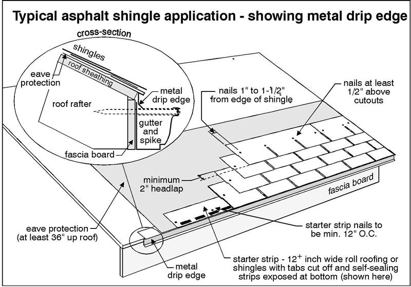

Posted
I like to see the drip edge installed on the sheathing first and the eave protection on top of it, shingle style if you will. This way, it can direct water in the gutter system more effectively than if it's on top.
Being on top is not totally wrong but in the event of an ice dam condition it wouldn't be as effective.

Posted
Edited to add:
This is what I mean
Download Attachment: icon_photo.gif RoofingDripEdge (Medium).JPG
92.02 KB
Thank you for the illustration, that is the one I used in my report. It being underlayment.
Thanks again to everyone for the response.
Posted
Hi,
That illustration is the way that felt is installed but IWS is installed with the drip edge over the top of the IWS. Manufacturer's installation instructions take precedence.

Wrapping the eaves protection behind the troughs is something we don't do here. We want to direct water INSIDE the gutters and not behind them, the drip flashing is an option (not mandated by code) to further aid in the process.
Placing the flashing over the eaves protection or IWS, simply doesn't make any sense.
Posted
Well, actually, it makes perfect sense, if one gets all the details correct. You can have water directed into the gutter, you can prevent ice dams backing water up under the felt, and the drip edge is installed over the IWS so as to protect the exposed "break edge" in the membrane.
I've "solved" several otherwise impossible eave ice dam issues with wrapping IWS behind the gutter, and drip edge metal over the IWS and lapped into the gutter.

First of all drip/rake edge isn't flashing, it performs the same function as a shingle molding, it is designed to cover the edge of the sheathing and support the portion of shingle that projects beyond it. Granted, when we started making these things out of metal we designed some water shedding features into them, but they are not flashings. In ice dam country if the ice and water shield is on top of the drip edge, it provides no protection at the point the ice dam starts, by wrapping the IWS over the edge of the sheathing and onto the fascia the protection is extended past the top edge of the gutter where it is needed most. Further more, you do not want to apply any adhesive roofing material to aluminum drip edge, it will curl up the first time it gets cold. Ask me how I know this.

I think some folks are mixing up IWS and underlayment in their heads. IWS is used below the felt and it's the felt that's supposed to overlap the drip; not the IWS.
