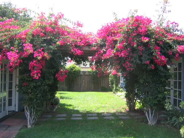

Looks like a Bougainvillea gone wild. We only have them in pots as they don't like the cold.
Thats not wild. Here in the valley of the sun that is a every day occurrence.
I have two of those in my front yard and one in my back yard. 6 months ago I cut them down to about 3 feet high. Two of them are back over 10 feet.
those same two are up against a block Wall and there is no damage from them.
My neighbor has a Ivy (Sorry I don't know what kind)in his yard that is playing hell with his block wall, it has grown through the wall and out the other side.
