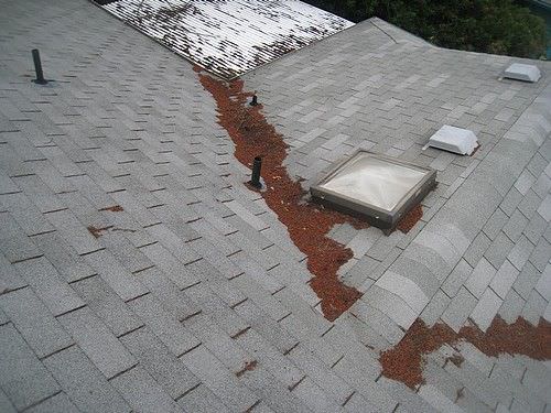

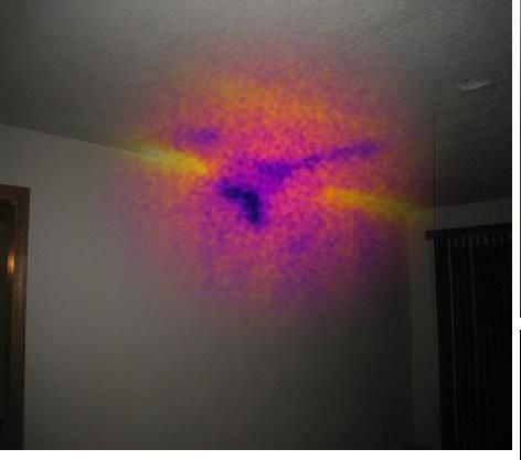

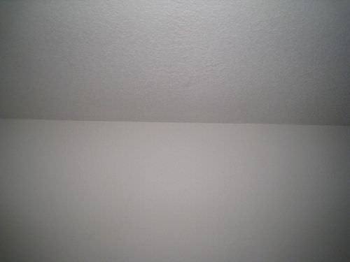

Chris Bernhardt Posted June 22, 2009 Report Posted June 22, 2009 I had completed my visual inspection and was just starting my IR scan of the family room addition when I discovered this. Click to Enlarge 26.95 KB Infrared composite pic of drip pattern in carpet next to interior wall in a family room addition. Click to Enlarge 38.63 KB View of carpet. Carpet felt dry to the touch. Click to Enlarge 15.2 KB Composite IR pic of wall and ceiling. Dark areas scanned positive for moisture with my moisture meters. Click to Enlarge 12.45 KB View of ceiling. There is a fine joint crack, otherwise there are no moisture stains or other visual signs of leaking. Click to Enlarge 53.94 KB View of roof. I think it's either leaking in the valley or at the skylight and then following the original top chord of the truss down to the top of the wall just past the other side of the skylight. I could not get to this area in the attic. I would have never found it without using an IR camera. Chris, Oregon
