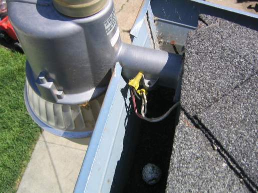

crusty Posted August 4, 2004 Report Share Posted August 4, 2004 I hate to brag but we have better non professional electricians out here. Download Attachment: Copy of 145_4525.JPG 37.11 KB Link to comment Share on other sites More sharing options...
Brian G Posted August 4, 2004 Author Report Share Posted August 4, 2004 Originally posted by Jim Katen Was he an engineer, by any chance? Definitely not. Crusty, I gotta admit that's really special work in your photo. Brian G. Link to comment Share on other sites More sharing options...
Les Posted August 4, 2004 Report Share Posted August 4, 2004 Crusty - how did you get on my roof? The dog has been outside everyday! Damn - forgot the wife's been inside Link to comment Share on other sites More sharing options...
