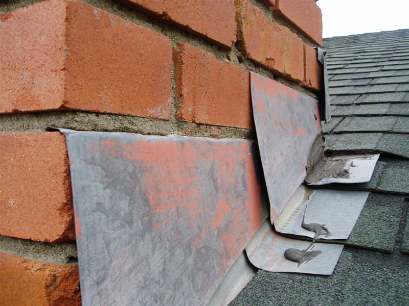

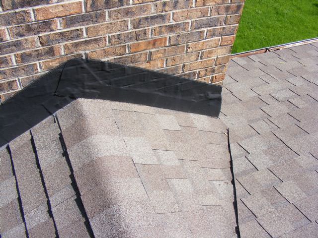

Jeff Beck Posted May 14, 2009 Report Posted May 14, 2009 Anyone had experience with flashing membranes as counter flashing on chimneys? I saw this at this morning's inspection but can't identify the manufacturer or find an installation manual. I'd appreciate any comments or advice. Thanks, Jeff Click to Enlarge 95.43 KB Click to Enlarge 91.11 KB
caryseidner Posted May 14, 2009 Report Posted May 14, 2009 Jeff, There are some peel and stick EPDM products that would work okay, but if it's H2O shield than it is wrong because it is not UV stable. From the photos, the right-hand side looks like EPDM to me, but the left-hand side looks more like an emulsified coating.
kurt Posted May 14, 2009 Report Posted May 14, 2009 Membranes have to be mechanically fastened when used as flashing @ vertical applications. There should be a termination bar and a counterflashing strip. After that, I'd have a lot of other commentary depending on a lot of stuff, but that's where I'd start.
Tom Corrigan Posted May 15, 2009 Report Posted May 15, 2009 Most Building Codes require that there be a minimum separation between the chimney and combustible materials. This would eliminate the EDPM or tar approach to counter flashing. What Code is used in your area? What does that Code require? Tom Corrigan
pupdawg Posted June 1, 2009 Report Posted June 1, 2009 That's a epdm band-aid. There's no manual for this. The product is designed to be used in a flat roof system, not to flash the top of old step flashings. It may work for a while (probably won't) , but I wouldn't have wouldn't have a lot of faith in this detail. Just my opinion.

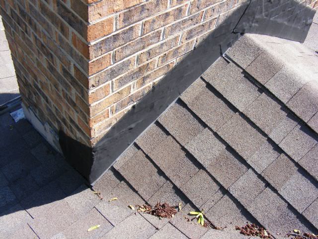

RobC Posted June 1, 2009 Report Posted June 1, 2009 Anyone had experience with flashing membranes as counter flashing on chimneys? I saw this at this morning's inspection but can't identify the manufacturer or find an installation manual. I'd appreciate any comments or advice. Thanks, Jeff No. Identifying the manufacturer has no relevance to your inspections in this case. The product is not intended for this application. Aside from the fact that the material will shrink, peel, melt, and dissolve over time, visualize water draining on the brick surface and where it's going to end up; that will answer the question you should be asking. I shot this just for you from this mornings' inspection Download Attachment: RoofingChimneyMasonCounter (Medium).jpg 94.88 KB This is the illustration I would include in my report Download Attachment: ChimneyCountFlashing (Medium).JPG 85.12 KB
