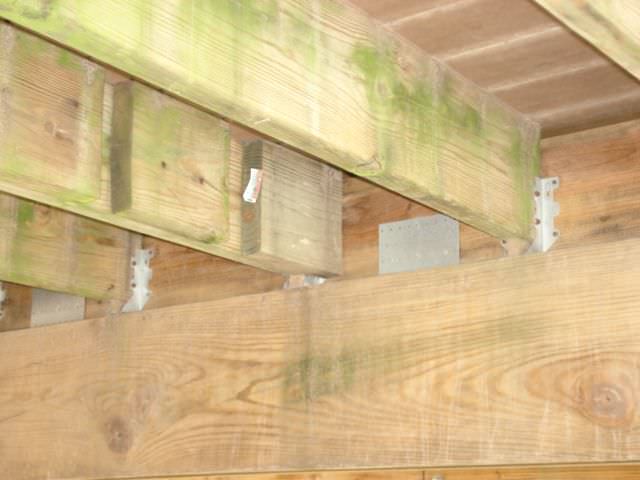

asihi Posted September 14, 2009 Report Posted September 14, 2009 Here's a picture of a deck I did last week. Besides many other problems, the joist hangers are a classic. This is a townhouse development where they are all the same! That's a deck built by pros. Nice. Here's a photo of a deck built by a resident in my jurisdiction. He'd never built anything before. I answered a few of his questions then handed him a prescriptive deck building document I copied from somewhere and a Simpson Deck Accessory Catalog. He's pretty proud and I told him I'd share the photos with you folks. Darren's photo is why I don't use the terms professional or amateurish in my reports any longer. I still use "crappy" or "built by a fourth grader". Click to Enlarge 51.71 KB Chad please elaborate on this deck. From the limited view that we see in the picture, what about it didn't you like? Maybe some sway bracing? How tall was the deck off of the ground? The only thing that looks a little strange is how he attached the beams to the posts with those connectors, but it looks like he used these http://www.strongtie.com/products/connectors/DJTZ.asp Though it would be nice to see some through bolts. Just curious. Tony

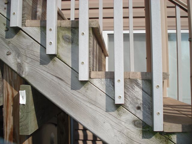

asihi Posted September 14, 2009 Report Posted September 14, 2009 Tony, I think it's a swell deck. I posted it to share because it's a deck built nicely by a conscientious DIY'er I'm sorry. I misunderstood your point. I thought the deck was nicely put together compared to some of the stuff I've been seeing lately. The homeowner of this deck swears he paid someone to build it, but I suspect otherwise...but you never know. Click to Enlarge 64.82 KB Click to Enlarge 44.47 KB Click to Enlarge 56.04 KB
gtblum Posted September 14, 2009 Report Posted September 14, 2009 Click to Enlarge 56.04 KB Let me guess. Those are cut outs from the stringers to the stairs at the other side of the deck? Brilliant use of material that would have been wasted. How green of them.
