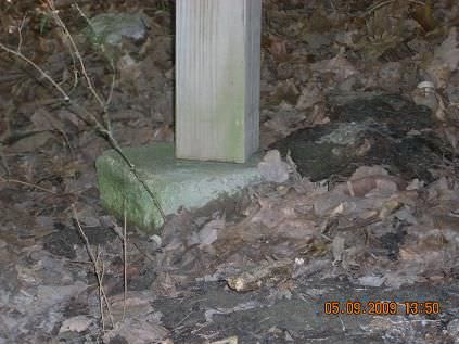

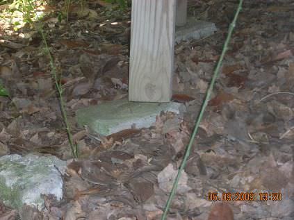

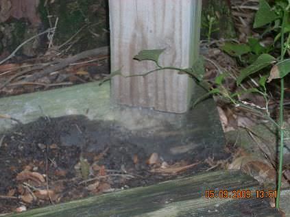

From Saturdays inspection....Deck built to code BFUM 3427.3
New floating pier design (yes there is 2in between pier and footing)
Click to Enlarge
32.62 KB
Click to Enlarge
30.62 KB
And here is how we prevent pier from contact the soil, sit on on a retaining wall member.
Click to Enlarge
29.25 KB
