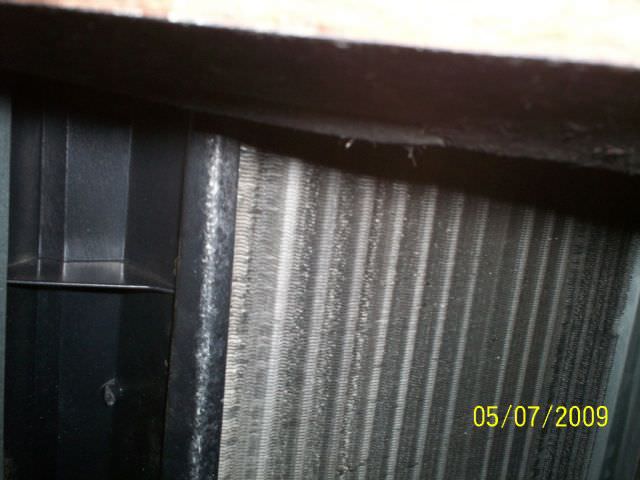

iceman_ch Posted May 7, 2009 Report Posted May 7, 2009 I'm sure this question comes up alot in the summer but, here it goes. My interior unit has what I think is called the condensor but, I'm sure what the exact word for it is. It's the part that gets cold and air is pulled through. Anyways the unit is in the closet in a the kitchen. The condesor is angled at a what looks like a 45 degree angle but, it might be a bit more then that. In normal operation I assume that the water that builds up on the unit is supposed to trickle down the unit and drip in to a drip pan. Well it's not working..... It's dripping about midway down the unit. I've tried vaccuming it out since it looks like it's built up some dirt on it but, this dosn't seem to be working. Does anyone have any tips for stopping the drip?? Maybe a very light coat of WD-40 or do I just need to keep vaccuming?

Jim Katen Posted May 7, 2009 Report Posted May 7, 2009 I'm sure this question comes up alot in the summer but, here it goes. My interior unit has what I think is called the condensor but, I'm sure what the exact word for it is. It's the part that gets cold and air is pulled through. It's called the evaporator coil. I know that sounds strange because water is condensing on it. But inside the coil, the refrigarant is evaporating. Anyways the unit is in the closet in a the kitchen. The condesor is angled at a what looks like a 45 degree angle but, it might be a bit more then that. In normal operation I assume that the water that builds up on the unit is supposed to trickle down the unit and drip in to a drip pan. Well it's not working..... It's dripping about midway down the unit. I've tried vaccuming it out since it looks like it's built up some dirt on it but, this dosn't seem to be working. Does anyone have any tips for stopping the drip?? Maybe a very light coat of WD-40 or do I just need to keep vaccuming? This is a very common problem in AC units that haven't been properly maintained. You've described the issue perfectly. The built-up crud on the coil is preventing the water from slipping down the coil into the condensate pan. Instead, the water drips off the coil, misses the pan and makes a mess. The solution is to clean the coil properly. You can't do this. You'll screw it up. The vacuum cleaner attachment will bend the fins and make things worse. Also, a vacuum cleaner is the wrong tool to use anyway; it won't be effective. WD-40 will just attract more dirt and make the coil even harder to clean. Just put down the WD-40 and step away from the air conditioner. Hire an AC tech to clean the coil and check out the rest of the system. If the coil is dripping water, there are undoubtedly other problems with the system as well. (The coil cleaner is sold in special HVAC supply stores where you have to know the secret password to get in. Whoever fixes this will probably also need a coil comb to straighten out the fins that you bent.) - Jim in Oregon

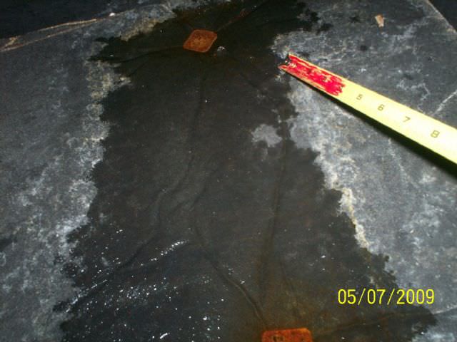

Phillip Posted May 7, 2009 Report Posted May 7, 2009 Here is a photo of a coil like you are talking about. This one is took from the return air looking up. It is a heat pump and the coil is in the bottom area of the blower unit/furnace. Click to Enlarge 44.28 KB It is dripping also. Click to Enlarge 51.35 KB
