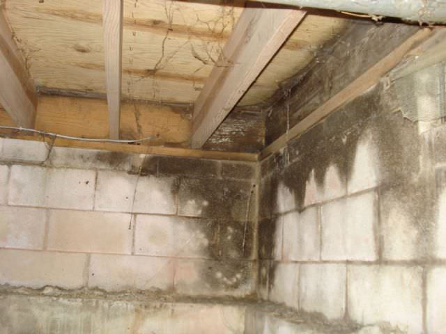

Bain Posted April 29, 2009 Report Posted April 29, 2009 Since we're playing show 'n' tell, check out this yuck from a couple of weeks ago. The mold hysteria is overblown, but the stuff does pack a punch. When I left this house, my eyes were watery and itchy, my throat felt constricted, and I had a horrible headache. Click to Enlarge 47.71 KB Click to Enlarge 48.76 KB Click to Enlarge 49.48 KB Click to Enlarge 53.39 KB

randynavarro Posted April 29, 2009 Report Posted April 29, 2009 Nice. Very nice. In Bain's crawl space photos, the darkened areas in the wood, then, are enzyme stains? Aggravated by moisture?
CaoimhÃn P. Connell Posted April 29, 2009 Author Report Posted April 29, 2009 Photos #2 and #5 are tricky. The dark discoloration may contain mould, but it is not consistent with a fulminant bloom. Based on the photos, Iââ¬â¢m going to guess the discoloration is not primarily due to mould and is not predominantly mould. By the way, I learned a valuable lesson. When you post a reply don't click on the "Check here to subscribe to this topic." Otherwise you'll get a email respnse for EACH check mark - Help! CPC (The opinions expressed here are exclusively my personal opinions and do not necessarily reflect my professional opinion, opinion of my employer, agency, peers, or professional affiliates. The above post is for information only and does not reflect professional advice and is not intended to supercede the professional advice of others.) AMDG

Bain Posted April 29, 2009 Report Posted April 29, 2009 I don't get it. If the stuff in my photos isn't mold, what is it? And why would it migrate down the foundation wall?
CaoimhÃn P. Connell Posted April 29, 2009 Author Report Posted April 29, 2009 Good morning, Gents: Iââ¬â¢ve read some good comments and criticisms. So Iââ¬â¢ll address those (The last post at the time of this post was from J Bain 4/29 2009 at 05:00 AM. Remediators: Like anything else, remediators may or may not be a good thing. I have frequently recommended mould remediators (with all their moon suits and HEPA units) and I have frequently recommended against their services instead, recommending that the homeowner get ââ¬ÅJoe the Handymanââ¬
