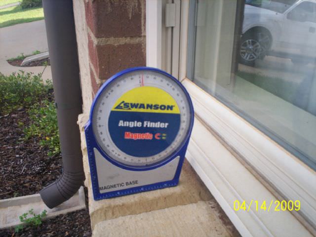

hausdok Posted April 21, 2009 Report Posted April 21, 2009 Am I the only one who ever put one of those protractor/level hickeys on brick window stools, to actually confirm or rule out the 15-degree pitch (per BIA last time I looked)? WJ Nope. OT - OF!!! M.
John Dirks Jr Posted April 21, 2009 Author Report Posted April 21, 2009 I check for slope on the brick sills but I havn't actually measured the angle. 15 degrees minimum huh? Now I know.
Brandon Whitmore Posted April 21, 2009 Report Posted April 21, 2009 Let me suggest that you confirm that via the BIA. It's been a while since I protracted a brick window stool. The gizmo, as I recall, cost $5.00 or so at the big orange box... 15 deg. is correct. Problem is, our building code does not require 15 deg. , it's just best practice. I write them up all the time, and have one of those angle gizmo deals as well.

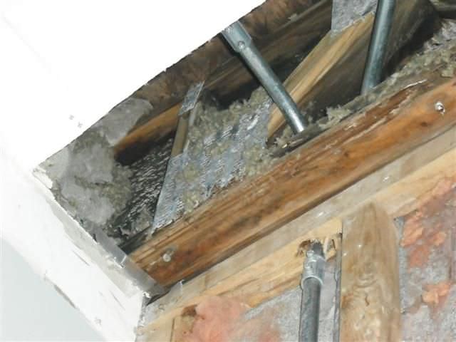

kurt Posted April 22, 2009 Report Posted April 22, 2009 In general, it's always good to build so water runs off whatever it is you're building, including window sills. It's amazing we have to explain this stuff. I'm starting to see the results of 10 years worth of really crappy masonry construction with details like this. It's not pretty; in fact, some of it is downright terrifying. I'm seeing buildings where there is a distinct likelihood of structural failure, possibly catastrophic, due to simple little details like flat window sills. Looky here........ rot due to the omission of some little thing, like, oh, say.......(cue up the Church Lady)....... FLASHING? Click to Enlarge 43.32 KB
