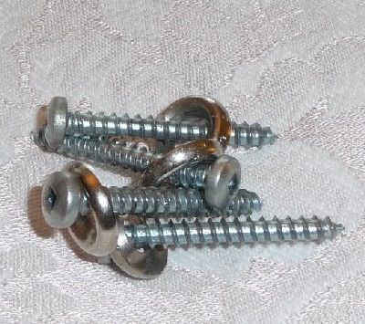

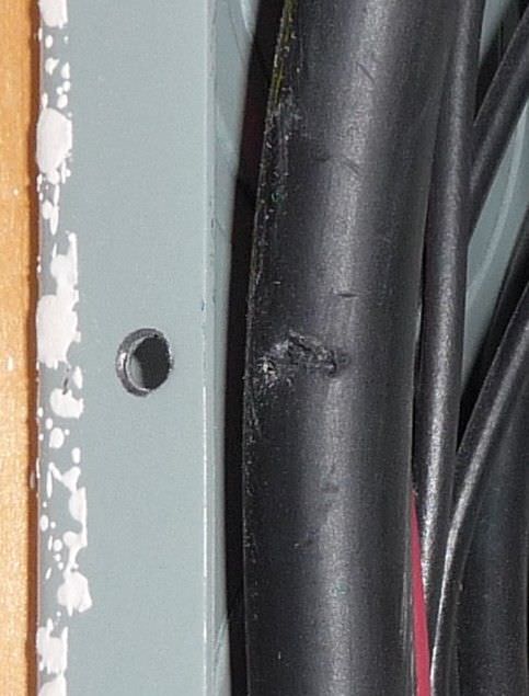

Richard Moore Posted April 15, 2009 Report Posted April 15, 2009 Why you shouldn't mix these... Click to Enlarge 45.58 KB with one of these... Click to Enlarge 57.42 KB Very, very, scary close! Click to Enlarge 53.84 KB
randynavarro Posted April 15, 2009 Report Posted April 15, 2009 I've unintentionally produced sparks from a main panel two times in my inspection career -both times as a result of using the manufacturer-supplied screws As they were screwed in, the screws pinned the cable against the side of the panel and the threads tore through the vinyl sheath. I still call out sharp-tipped screws, though. Now, I just make sure all the holes are reasonably clear of any wires that could contact the screw-regardless of what type of tip.

sepefrio Posted April 15, 2009 Report Posted April 15, 2009 This is one of those "little" things I see on a not too frequent basis that although of course is important and should be noted, often gets blown out of proportion. IMHO, there is a simple and cheap fix to these problems that has paid for itself a couple of times over. I carry an assortment of panel screws in my truck and use these to re-install the panel. I don't consider this a "fix" as we have to put the screws back in anyways and if we re-install the panel with the wrong screws, aren't we just committing the same error we are pointing out? It's like $4 for a pack of 6 screws at the box store but I think it's one of those extra little steps we can take to make all sides happy without compromising any ethics or codes. I also carry things like the basic receptacle covers and insulation for HVAC lines. I might spend $100-$150 a year, but I am also convinced this has helped me get more previous client referrals and repeat customers. NOTE: This does not apply if for example the wiring is damaged or other problems exist.

Richard Moore Posted April 15, 2009 Author Report Posted April 15, 2009 This is one of those "little" things I see on a not too frequent basis that although of course is important and should be noted, often gets blown out of proportion. Agreed, not a big deal (but called) unless, like mine, the screw is buried in the SEC. I swear the hole was deeper than the insulation was thick, although I couldn't actually see metal. IMHO, there is a simple and cheap fix to these problems that has paid for itself a couple of times over. I carry an assortment of panel screws in my truck and use these to re-install the panel. I don't consider this a "fix" as we have to put the screws back in anyways and if we re-install the panel with the wrong screws, aren't we just committing the same error we are pointing out? There, I'm going to disagree a little. To me it's another indicator of a homeowner being in the panel and I would normally want it in the report. Especially in occupied home, I leave 'em as I find 'em (immediate deathtraps excluded). I DO make sure there are no wires that could come in contact before replacing the screws. In this particular case, it was a pre-list inspection (verbal only), the homeowner was shown the problem, and I left that one screw out. I also managed to force a small kink into the SEC so that even a blunt screw won't come into contact. I do carry extra screws for when I drop one and can't find or get to it. Touch wood, I've been fortunate so far. The only "shocks" I've had are when a client suddenly takes a flash photo just as I'm removing the cover. That can make me jump!

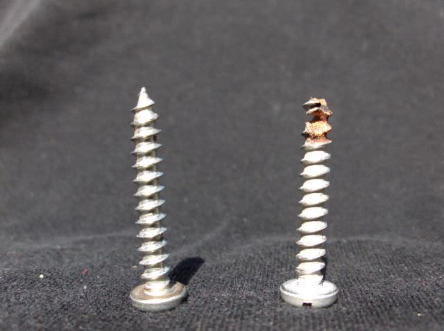

kurt Posted April 15, 2009 Report Posted April 15, 2009 I've blown up a couple panels with those. Both times were on the way out. Scared the bejeezus out of me.

Brandon Whitmore Posted April 16, 2009 Report Posted April 16, 2009 I've blown up a couple panels with those. Both times were on the way out. Scared the bejeezus out of me. I had it happen once. I swore lightning struck right next to me.........
hausdok Posted April 16, 2009 Report Posted April 16, 2009 I've blown up a couple panels with those. Both times were on the way out. Scared the bejeezus out of me. I had it happen once. I swore lightning struck right next to me......... Uh huh, Really, really loud pop and a flash, right? Loud enough to bring the neighbors running over 'cuz they thought someone had discharged a pistol, right? Ear-ringing loud, right? Yep, been there, done that. ONE TEAM - ONE FIGHT!!! Mike
AHI in AR Posted April 16, 2009 Report Posted April 16, 2009 I found one that fortunately didn't contact the wire on the way out. However, what's left of the tip is nicely electroplated in copper from the experience. I stuck the photo on my site to show folks why we inspectors would mention such a small item. Click to Enlarge 37.42 KB

Jim Katen Posted April 16, 2009 Report Posted April 16, 2009 Just curious, lets say you come across a panel using all sheet metal screws. Do you re-install the panel with those same screws or do you leave the panel off. For the sake of the discussion, lets say there is no apparent immediate danger for putting the screws back in? I'd never put a sharp screw back into a panel. I carry panel cover screws, just as you described in an earlier post. The sharp screws get tossed in the trash and the real panel cover screws go in. BTW, my local Ace hardware store sells those screws for a fraction of the cost at the dumbass box store. Ace: $1.69 for six screws. Dumb Box Store: $2 for two screws. I keep about a dozen screws in my inspection bag and about 50 of them in the car. I never replace a panel cover without every screw hole filled with a proper screw. - Jim Katen, Oregon
