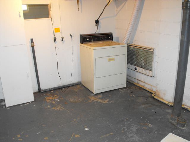

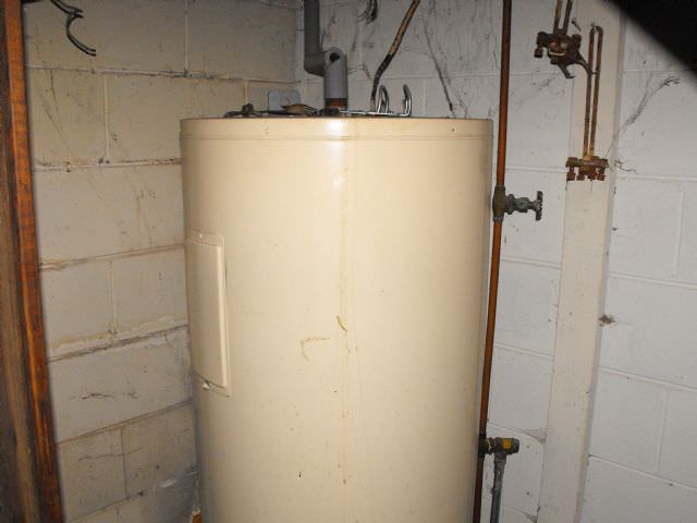

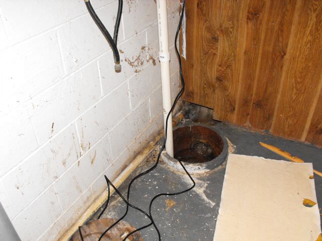

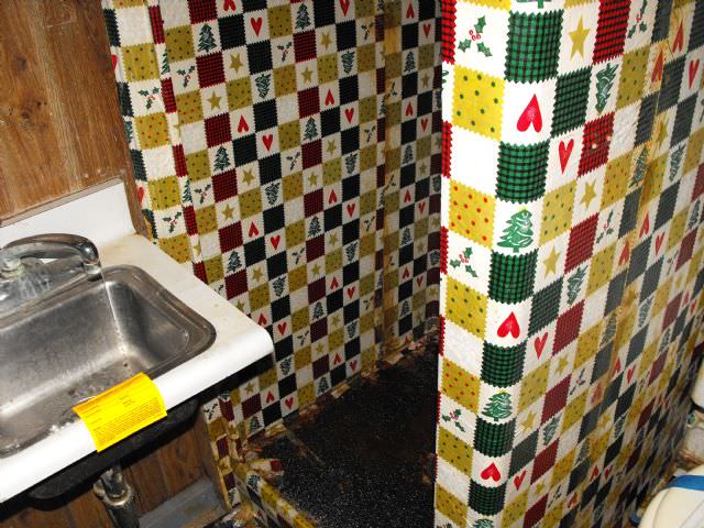

Les Posted April 13, 2009 Report Share Posted April 13, 2009 Bob, Took these photos while with one of our inspectors last Friday. I think they kinda relate to how an inspector can manage expectations while inspecting foreclosed house. The inspector, a long time ASHI member, clearly informed client this inspection was unique and had many limitations. He was very specific about these limitations. The photo comments are not a copy of the final report, just my glib comments in a comic book format. Click to Enlarge 28.68 KB Replace overloaded main electric service entrance panel. The house is heated by radiant electric wall units, most have broken t-stats or broken components. See following photos Click to Enlarge 35.91 KB This photo shows unsafe washer and dryer hook-ups. Drain from washer goes to floor drain out of photo. Replace electric circuit and dryer vent. Electric wall heater on right of photo is typical and does not shut off with t-stat. Click to Enlarge 34.51 KB Replace 82gal 57year old electric water heater. This type unit uses large heating elements in the tank and are quite inefficient. This water heater was heating during the inspection, however the exterior casing reached 160degrees from heat loss. Improper/unsafe T&P protection. Click to Enlarge 95.58 KB Click to Enlarge 71.75 KB Repair or replace wallpaper in lower shower stall. Wallpapered shower stalls usually are an indication of a shower stall that is not correctly installed. Shower can't drain onto the floor and run across floor into sump pump pit. Click to Enlarge 49.97 KB This is where shower and washing machine terminates; open sump pit. This situation must be corrected by tradesperson. The plumbing, heating and electrical systems in this house are unsafe and not functional at this time. Recommend having licensed tradespeole estimate cost to remedy all three systems. We did not and can not list and report all flaws and defects in this house. We have discussed the major systems and their condition. blah blah blah Point is I believe it is most important to manage client expectations. They know the plumbing, heating and electrical systems are in poor unsafe repair/condition. Bank ain't gonna do nothing. Link to comment Share on other sites More sharing options...
