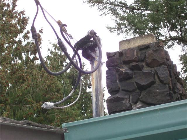

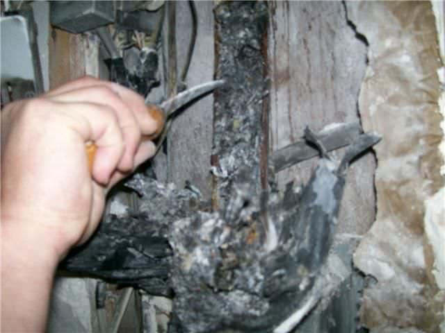

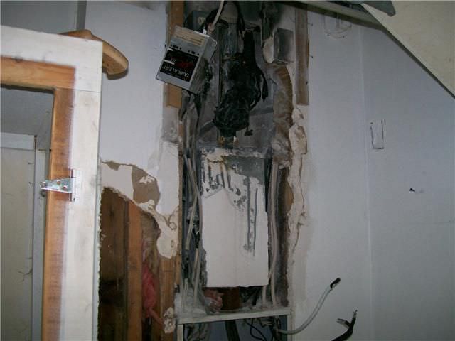

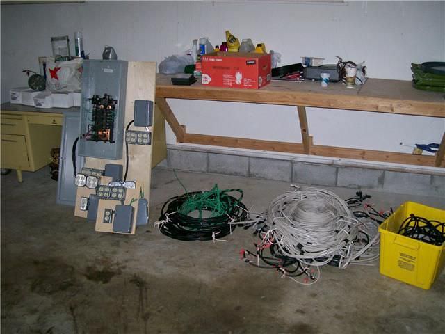

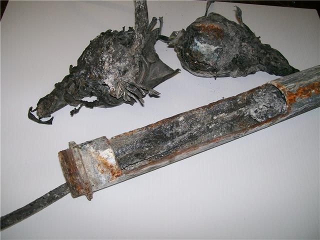

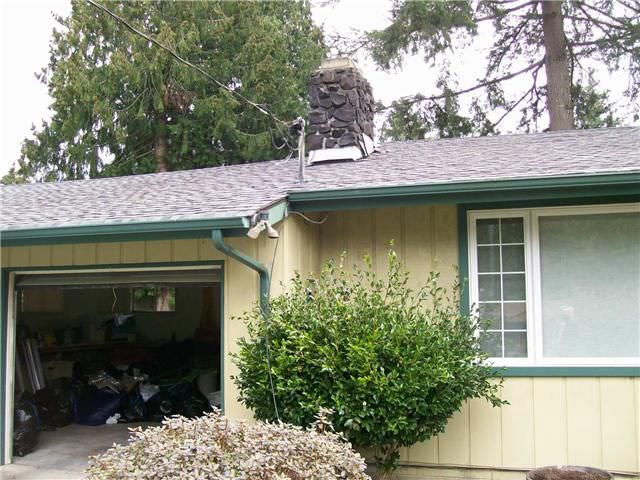

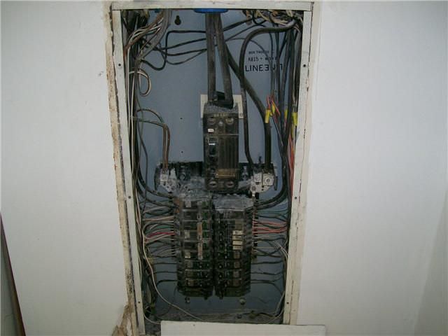

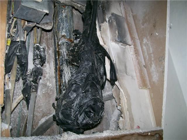

Hi All,
These people were growing Pot in the basement. Grow lights use a lot of power. They cut the main mast inside the garage (ahead of the power meter) and tapped to the power line (large black mass). They ran the power to the basement and set up taps to the grow lights. Almost burned the house down.
The police had already removed the Pot and the grow lights when we got there.
