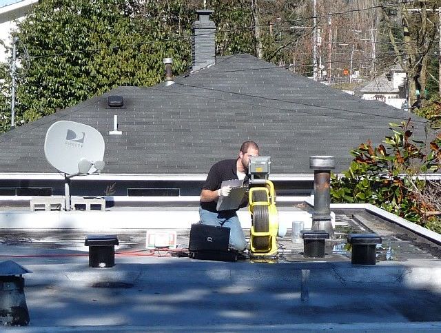

Richard Moore Posted March 1, 2009 Report Share Posted March 1, 2009 I'd be ashamed if I wouldn't at least go as high as the sewer-scope guy! Click to Enlarge 101.19 KB Link to comment Share on other sites More sharing options...
Darren Posted March 1, 2009 Report Share Posted March 1, 2009 I think the sewer scope guy is looking for attorneys.... Link to comment Share on other sites More sharing options...
kurt Posted March 1, 2009 Report Share Posted March 1, 2009 Going in through a vent stack is not uncommon. If there's no cleanouts, it's the easiest way to do it. Link to comment Share on other sites More sharing options...
hausdok Posted March 1, 2009 Author Report Share Posted March 1, 2009 Hi, That fellow and his brother are practically artists with that thing. Good work for a fair price. If you're an inspector in King and Snohomish Counties, those are the guys you can safely refer your clients to and be confident they won't try and upsell a hugely expensive and unnecessary job. Hydrophysics Pipe Inspection Rick Delemare 425-775-8445 www.hydrophysics-wa.com ONE TEAM - ONE FIGHT!!! Mike Link to comment Share on other sites More sharing options...

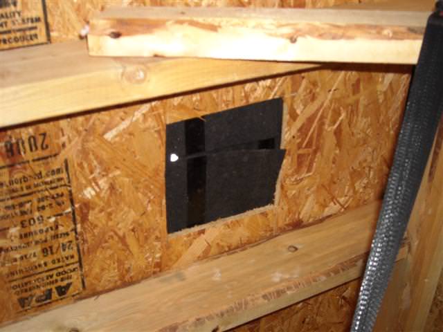

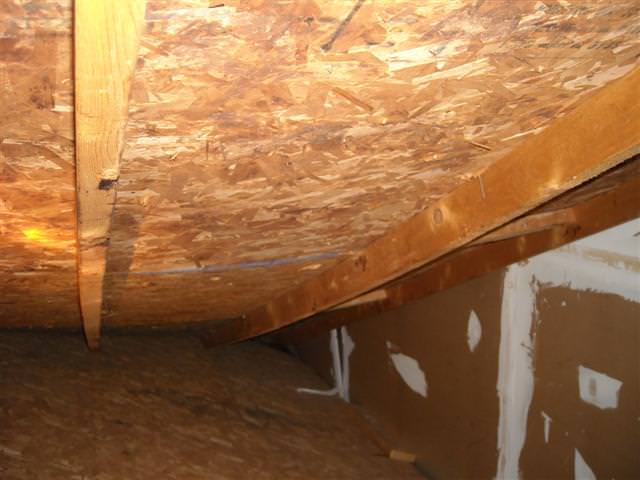

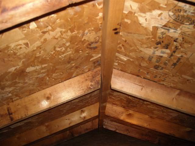

hspinnler Posted March 1, 2009 Report Share Posted March 1, 2009 [speaking just for myself, if an HI can make a decent assessment of a roof ... from the attic I say he's doing fine. WJ I guess you're only speaking for yourself, but how does a H.I. determine the condition of a roof from the attic. We're not talking leakage. I did not walk the section with the obvious deflection. After going inside, I found that a section of roof joining two dwelling units was framed with 2" x 4" rafters and ridge board. (Pics 1-3) It pays to check "under the hood" first because on more than one occasion, I have found a shingled over cut-out for a removed (new roof - existing construction) or missing (new construction) passive vent. Hate to unexpectedly step through one of those (Pic 4) Click to Enlarge 96.67 KB Click to Enlarge 51.03 KB Click to Enlarge 50.28 KB Click to Enlarge 52.22 KB Link to comment Share on other sites More sharing options...
