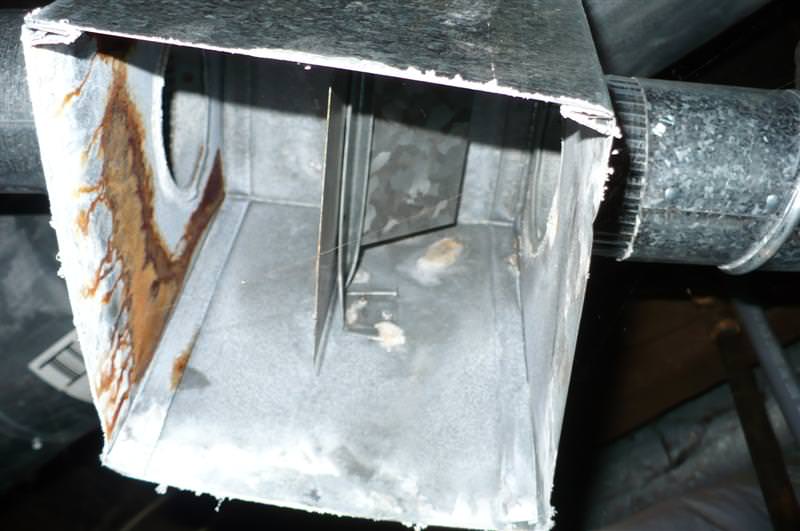

gtblum Posted January 27, 2009 Report Posted January 27, 2009 Is this an off the shelf setup or the work of a tin knocker expressing himself? Click to View 42.34 KB Click to View 78.07 KB He forgot a part. Good thing I'm short. Click to View 67.1 KB
Neal Lewis Posted January 27, 2009 Report Posted January 27, 2009 I've seen them quite a few times, usually due to height limitations. I believe it's an off the shelf piece. Forget the name. The bottom is supposed to be open. It is installed instead of the draft hood.
gtblum Posted January 27, 2009 Author Report Posted January 27, 2009 Originally posted by Neal Lewis I've seen them quite a few times, usually due to height limitations. I believe it's an off the shelf piece. Forget the name. The bottom is supposed to be open. It is installed instead of the draft hood. Thanks Neal. How does it work?
Bill Kibbel Posted January 27, 2009 Report Posted January 27, 2009 It's an external draft diverter for older systems that aren't manufactured with an integral draft hood.
