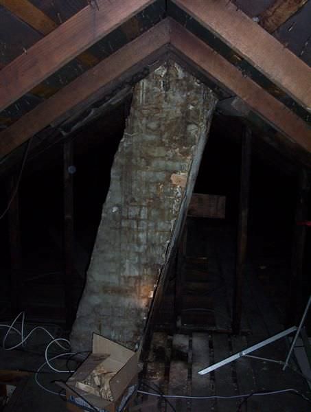

Mike Lamb Posted December 21, 2008 Report Share Posted December 21, 2008 I believe this was asked before but I couldn't find it. Why are chimneys in old house (70+ years) offset in the attics. To help prevent backdrafting? I see it so often. Click to View 38.4 KB Link to comment Share on other sites More sharing options...
kurt Posted December 21, 2008 Report Share Posted December 21, 2008 So the chimney would exit at the peak, where it can be flashed so it doesn't leak. They'd offset the chimney base so it wouldn't run up directly through the center of the house, and take it out the peak in the attic. Or, so I've been told. Made sense to me at the time. Back then, folks understood about the high sides of roof penetrations leaking. Link to comment Share on other sites More sharing options...
Bill Kibbel Posted December 21, 2008 Report Share Posted December 21, 2008 There are 3 different reasons a chimney may be offset: To penetrate the roof at the ridge so as to avoid having any roof slope above that would need to be diverted around the chimney (cricket) To avoid cutting and supporting a structural member Some architectural styles include chimney placement as part of the design. Link to comment Share on other sites More sharing options...

Mike Lamb Posted December 21, 2008 Author Report Share Posted December 21, 2008 Thanks. Sounds good to me. I'm not sure how old. According to Bill's drawing 100 years+. The 2Xs in the forefront are 1 1/2" so that was an add on, and behind the chimney a real 2". Link to comment Share on other sites More sharing options...

Rob Amaral Posted December 22, 2008 Report Share Posted December 22, 2008 Other reason is optimal draft... stubby little chimneys exiting at the ridge are not prone to the same problems with wind... Link to comment Share on other sites More sharing options...
msteger Posted December 24, 2008 Report Share Posted December 24, 2008 Yep, offset chimneys are pretty common around here in homes I've inspected from the 1700s and 1800s. I always figured it was to help flash it at the roof line to help prevent leaks. Link to comment Share on other sites More sharing options...
