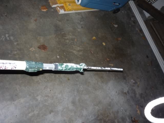

Tom Raymond Posted December 6, 2008 Report Posted December 6, 2008 Quote Originally posted by charlieb Quote Originally posted by Richard Moore Maybe you should add "I probe for rot using a custom tool". Personally I use my trusty "pointy stick", a quick action, heavy duty, telescoping painters pole, with a cut-off paint roller frame sharpened to a chisel point. Handle filled with expoxy to make it rock solid. Enables me to probe everything from higher eaves to rim-joists in crawls and doubles as a cobweb remover in the crawls. Might also be useful for fighting off racoons, but I've never had that "pleasure" yet. Mike...wassup with all the polls? You suffering from election withdrawal? Richard improved on my design. He added Epoxy. Must have cut off a cheap roller frame. I used a Wooster. It's got a thicker rod, don't ya know. Would you custom tool builders care to share pictures of your creations? Tom
charlieb Posted December 7, 2008 Report Posted December 7, 2008 Here ya go. This one extends another 4 feet. Image Insert: 61.79 KB Image Insert: 67.14 KB
Tom Raymond Posted December 7, 2008 Report Posted December 7, 2008 Thanks Charlie. For some reason I kept thinking that the roller frame was cut off after the bend, but that would loose all its leverage at full extension and snag stuff on the back side of joists that you may not want to snag. I guess I was over thinking it. Tom
charlieb Posted December 8, 2008 Report Posted December 8, 2008 Quote Originally posted by Tom Raymond Thanks Charlie. For some reason I kept thinking that the roller frame was cut off after the bend, but that would loose all its leverage at full extension and snag stuff on the back side of joists that you may not want to snag. I guess I was over thinking it. Tom I understand. I did cut this one after the bend. It was not hard to straighten it out.
