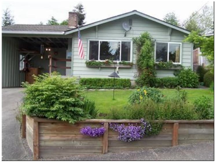

Originally posted by Chad Fabry
That depends on the definition of a carport I guess. What the heck is a carport anyway?
A carport is simply a roof structure--oftentimes supported by tacky wrought-iron or wood piers--that you park your car beneath to keep the snow off it and yourself while you walk inside your house.
There are often utility buildings at the far end of the driveway to store mowers and chain saws. I assume this is the set-up Phillip's photo is depicting.
Not to be a prick, but if you really want to spice up the debate, what if the gas or electrical water heater is in the utility building? Does the 18" code requirement still apply? And you have to understand, these utility buildings are typically filled to the gills with gasoline, oil, paint, and all sorts of other flammables.
Edit: I snagged this photo from Google. Clearly the white utility building would have to be beside the house to contain a water heater.

Posted
"Once again I guess I've failed to communicate very well. Sorry."
No, not at all! In fact, with Phillip's trap being at a carport closet, it could be subject to freezing (Alabama?) and potentially the same as having no TPR at all.
Perhaps I was just thinking out loud, but related drift is, well, related. So, no, I don't see the need to start a new thread everytime.

Been away for a while, but I'll offer some observations about Phillip's picture.
The TPR discharge tube is wrong. It's trapped and the flex section has a smaller diameter than the outlet of the TPR valve. My reference is the manufacturer's yellow tag and the IRC in section P2803.6.
If Phillip's area is under the IRC, then the TPR discharge is also wrong because it doesn't drain via an air gap in the same room as the water heater. (Same code section.)
I'm not aware of any rule in any code that would require this water heater to be elevated when installed in a carport or in a shed attached to a carport. If someone's aware of such a rule, please post the reference.
If the water heater were installed in a garage (not a carport), then I'd cite P2801.6 as a reason why it'd have to be elevated. It says:
P2801.6 Water heaters installed in garages. Water heaters having an ignition source shall be elevated such that the source of ignition is not less than 18 inches above the garage floor. There's an exception to this rule in P2498.2. It says that FVIR water heaters can be on the floor of the garage. In Oregon, the muni inspectors enforce these rules. That puts us in the ironic position of requiring our electric water heaters to be elevated while our gas water heaters can sit on the floor.
Oddly, as Jeff pointed out, the NEC allows switches and receptacles to be mounted on garage walls below 18". Even more strange, there's no rule against placing clothes washers and dryers with their sparky little motors right down near the floor of a garage, to say nothing of the dryer's heating elements or gas flames. And what about refrigerators & freezers? They have relays that probably produce sparks; are the relays located high or low? Does their location vary by brand and model? Should they be elevated when they're located in a garage?
Personally, I call out the electric water heater only because the munis do.
- Jim Katen, Oregon
Posted
Here is a photo of the front of the house. The carport is to the left. I did not get the left side of the carport in the photo; but it is open on the left side.
Image Insert:
118.06 KB
Here is a photo of a carport that open on three sides.
Image Insert:
162.88 KB
I like to see the TPR piping run to a place where it can be seen if it starts leaking.
