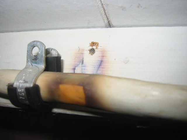

John Dirks Jr Posted October 31, 2008 Report Posted October 31, 2008 Take a look at this wire. Does the discoloration look like evidence of overheating? It felt kind of brittle in that area. It's a 10/3 serving a 30amp clothes dryer circuit. It's fed from a FP Stab-Lock nonetheless. There were 3 spots on this wire that looked like this. All were within 18 to 24 inches of each other. Image Insert: 91.28 KB Image Insert: 149.07 KB
Eric B Posted October 31, 2008 Report Posted October 31, 2008 I can't think of any reason other than something hot was placed on top of those cables.
Brian G Posted October 31, 2008 Report Posted October 31, 2008 I have to agree, that looks more like something hot laid on the wires than the wires getting hot themselves. Very odd. Brian G. FPE Sucks [:-yuck]
Mark P Posted October 31, 2008 Report Posted October 31, 2008 Were there any copper water lines near by? May the plumber got careless with his torch.
Jeremy Posted October 31, 2008 Report Posted October 31, 2008 I wonder why the wire staple was removed.

Jim Katen Posted November 1, 2008 Report Posted November 1, 2008 Originally posted by John Dirks Jr Take a look at this wire. Does the discoloration look like evidence of overheating? It felt kind of brittle in that area. It's a 10/3 serving a 30amp clothes dryer circuit. It's fed from a FP Stab-Lock nonetheless. There were 3 spots on this wire that looked like this. All were within 18 to 24 inches of each other. Those are some very interesting burn marks. I'm puzzled by them because I haven't been able to reproduce them. My first thought was like Mark's. I figured that it was a plumber's errant torch. But when I took a propane torch to a section of NM cable, the sheathing first got really shiny and soft then, almost instantly, started to burn & blister. Your cables don't show any sign of the shininess or blistering. Image Insert: 85.93 KB Then I thought, like Eric & Brian, that someone put something hot on the cables. So I heated up a piece of metal and touched it to the cable. The sheathing turned to taffy but it didn't really discolor. Image Insert: 77.87 KB Then I thought, "Maybe it's radiant heat." So I laid a piece of romex across the top of my old-fashioned toaster. The heat rising from the slots made the sheathing drippy. Then I pre-heated the toaster and then put the cable across. This gave me something like the burn pattern in your pictures, but the sheathing all around the burns was shiny. Image Insert: 74.97 KB Then I wondered what would happen if the wires inside got really hot. Not wanting to run that much current through them, I just stripped off the insulation from one end and held the wires over the gas range burner. The wires got cherry red and the insulation smoked like crazy and began to distort, but it never caused a burn pattern or any significant discoloration on the sheathing. Image Insert: 91.64 KB My last thought is that someone might have placed a halogen work light over the cables. My work lights are all burnt out so I can't try them, but I suspect that they'll create the same shiny texture that the toaster did. Of course, the romex that I'm working with is newer than yours and a different brand. Perhaps the outer sheathing behaves differently on your sample. - Jim Katen, Oregon
Inspectorjoe Posted November 2, 2008 Report Posted November 2, 2008 I came across similar discoloration today. It was on 10/3 non-metallic feeding the AC outside unit. The cable was attached to the basement wall with rubber lined clamps. The sheathing around every clamp was looked like it was burned. Image Insert: 60.2 KB I removed one and found the discoloration was actually lighter where the rubber had been in direct contact with the sheathing. Image Insert: 55.86 KB Could the rubber be out-gassing something that is interacting with the sheathing? I've always figured sheathing is pretty inert stuff. This raises more questions than answers.
Jim Katen Posted November 3, 2008 Report Posted November 3, 2008 Originally posted by Inspectorjoe . . . Could the rubber be out-gassing something that is interacting with the sheathing? I've always figured sheathing is pretty inert stuff. . . Wow. That sure looks to be the case. Either that or some kind of chemical reaction between the rubber and the white sheathing. - Jim Katen, Oregon
