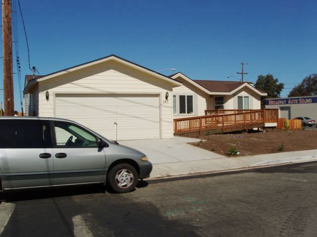

patt Posted April 5, 2009 Report Posted April 5, 2009 If I remember correctly they cannot mount meter 'on' a manf home??? Perfectly proper to mount the meter bases on a manufactured home, pedestals are mainly seen in MH parks. Click to Enlarge 26.09 KB Click to Enlarge 24.66 KB Click to Enlarge 28.98 KB Click to Enlarge 24.49 KB Click to Enlarge 26.83 KB In California MHs can be installed on most real property parcels (including city lots) zoned for single family housing. Local zoning and architectural requirements will apply. Click to Enlarge 41.69 KB The Feds passed a law a ways back prohibiting discrimination against manufactured housing and the states have adopted rules and regulation dealing with the installations of MH on private land. Most manufacturers of MHs have infill models specifically designed for city installations. Question...Any modular homes setup with a pedestal, or are they attached to the structure like other stick built home???????? If your state allows ââ¬Åmodularsââ¬

Tom Raymond Posted April 6, 2009 Report Posted April 6, 2009 I know of several stick built homes that have the meter and panel mounted on pedestals, including a local home builder who wanted power when he built his own home rather than mess with a generator, and several "trailers" with meters mounted on the buildings. Nearly every township in my area requires a permanent foundation under any new MH on a private lot, the most common is a "frost proof" foundation but I do see a few basements. If you wish to set one on piers with skirting around it, it must be in a park, on the reservation, or in one of the extremely rural towns. I prefer not to mess with mobiles, so I don't know the provisions for replacing existing units on private land. Tom
