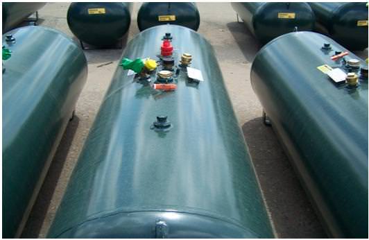

American Welding & Tank, in cooperation with the CPSC, has issued a voluntary recalled of more than 11,000 underground propane storage tanks due to a risk of leaks that can pose a fire and burn hazard. Inspectors finding these tanks should notify their clients of this recall and check with the homeowner to see whether the firm has already contacted them and has performed onsite repairs.
Name of Product: Conversion Underground Propane Storage Tanks
Units: About 11,000
Manufacturer: American Welding & Tank LLC, of Jesup, Ga.

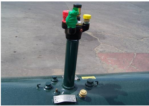

Hazard: An odorant is added to propane to help alert customers to propane leaks, but rust inside a propane tank can cause the odor to fade. Some converted above-ground to underground converted tanks can have an increased susceptibility to odor fade, causing consumers to be unable to detect the odor of propane in the event of a gas leak. This can pose a fire and burn hazard to consumers if there is a leak in the propane gas system.
Incidents/Injuries: The firm has received a report in which two individuals sustained first and second degree burn injuries, as they were attempting to ignite an outside fireplace.
Description: The recall includes 120 gallon to 1,000 gallon underground propane storage tanks which were previously converted from above-ground to underground storage tanks in the period of January 2005 through April 2008.
