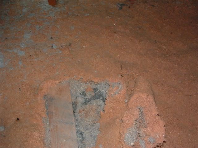

charlie Posted June 6, 2004 Report Share Posted June 6, 2004 Hello all, I posted this request for info about this insulation material on another forum and didn't get much response. In the picture, the small dark grey material at the center is rock wool, the lighter grey is standard cellulose fiber, and the blond material is __________? It appears to be some sort of cellulosic material ranging from small sawdust like particles to one inch shreaded-like strands. I have seen the material over the years remodeling but never had to call out what it was. Is it treated with fire retardant etc. Any feedback would be greatly appreciated, Charlie Download Attachment: Lau-b 149.jpg 54.81 KB Link to comment Share on other sites More sharing options...
kurt Posted June 6, 2004 Report Share Posted June 6, 2004 It's called Balsam Wool around here (Chicago). Sometimes I see it encased in an asphaltic paper batt. It's ground up pine trees, I think. Link to comment Share on other sites More sharing options...
charlie Posted June 6, 2004 Author Report Share Posted June 6, 2004 I am familiar with Balsam Wool----primarily installed prior to 1945. This stuff was installed in the early 80's and isn't nearly as powdery as Balsam Wool. Link to comment Share on other sites More sharing options...
hausdok Posted June 6, 2004 Report Share Posted June 6, 2004 Hi, It was sold out here under the brand name Silvawool. It's essentially shredded wood fiber. ONE TEAM - ONE FIGHT!!! M. Link to comment Share on other sites More sharing options...
Les Posted June 6, 2004 Report Share Posted June 6, 2004 If it is not "powdery" likely it is kelp/seaweed. Especially in your area. It was available in the 80's and treated usually with a borate. Really can't tell too much from the picture. Link to comment Share on other sites More sharing options...
hausdok Posted June 6, 2004 Report Share Posted June 6, 2004 Nope, It's Silvawool. I see the stuff 6 or 7 times a month. It's shredded wood that's been borate treated. OT - OF!!! M. Link to comment Share on other sites More sharing options...
charlie Posted June 6, 2004 Author Report Share Posted June 6, 2004 Thanks for the help, I finally found this info: SILVA WOOL: This is a product manufactured by the lumber industry. It consists of wood slivers treated with a fire retardant. The most common wood appears to be cedar that is resistant to rot and pests. The insulating qualities are quite good, however the quantity is often inadequate by today’s standards and additional insulation should be installed. Link to comment Share on other sites More sharing options...
