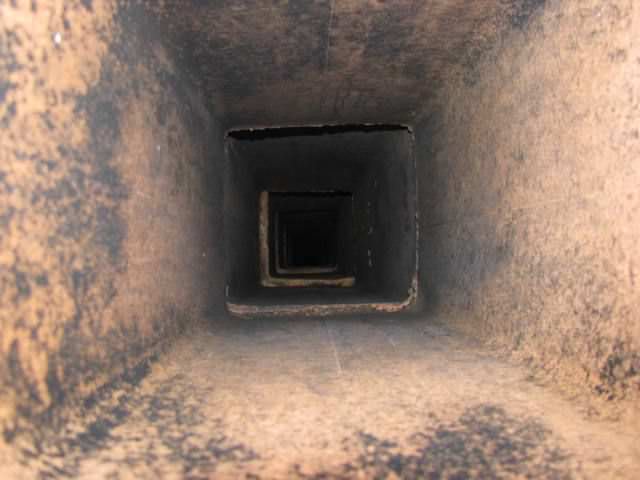

travismoshier Posted October 10, 2008 Report Posted October 10, 2008 How far can a chimney flue be offset? Here is a picture looking down the chimney. This chimney is used by a natural gas furnace. Image Insert: 57.4 KB

kurt Posted October 10, 2008 Report Posted October 10, 2008 Depending on the size of the furnace and whether or not the chimney is on an outside wall, you may want/need a metal liner in there.

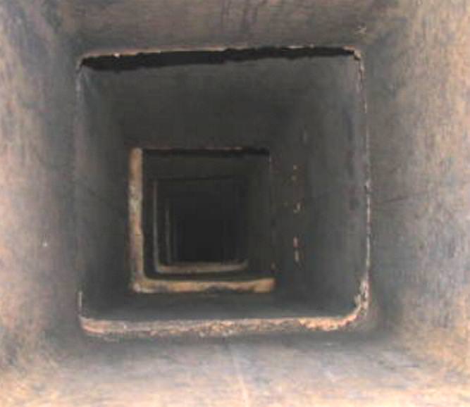

Bill Kibbel Posted October 10, 2008 Report Posted October 10, 2008 That chimney flue originally vented an oil-fired system. It wasn't adequately cleaned when the conversion happened. Oil combustion deposits plus gas combustion condensate equals sulphuric acid. As Kurt said, it's also probably oversized now. Here's your same picture, enhanced to see further down the flue. There's another offset that's more significant. There's also spalling starting on the left side of one section. There's probably more further down. I would also have tried to take a pic from the bottom of the flue. If there's no clean-out, the flue connectors sometimes magically open up enough to reach in with a camera.

travismoshier Posted October 10, 2008 Author Report Posted October 10, 2008 Quote Originally posted by inspecthistoric That chimney flue originally vented an oil-fired system. It wasn't adequately cleaned when the conversion happened. Oil combustion deposits plus gas combustion condensate equals sulphuric acid. As Kurt said, it's also probably oversized now. Here's your same picture, enhanced to see further down the flue. There's another offset that's more significant. There's also spalling starting on the left side of one section. There's probably more further down. I would also have tried to take a pic from the bottom of the flue. If there's no clean-out, the flue connectors sometimes magically open up enough to reach in with a camera. You are right. The furnace was an old oil furnace converted to natural gas. It's the first one I've seen. The thing sounded like a jet was about to take off. Thanks for everyone's input.
Eric B Posted October 13, 2008 Report Posted October 13, 2008 Travis, Did you see any mortar in the liner joints? I would say that there is none. If a metal liner goes in then it's not an issue. I realize that most inspectors will not take off the flue cap but there can be a world of problems inside and considering the potential for down the road grief I think that it's worth the effort. And yes, it's above and beyond the "call of duty."
Mike Lamb Posted October 14, 2008 Report Posted October 14, 2008 Travismoshier, Did you take pictures of the exterior of the chimney? Was it experiencing problems? Brick and mortar failure? Efflorescence? Did this serve a fireplace? How about vent problems near the furnace or water heater? Staining at the vent sleeves, etc.? How did the chimney look in the attic? Was the furnace newly installed? Was the the chimney newly pointed or repaired? Chad, the chimney flue in your photo had some exterior problems? Or was it a newer construction?

travismoshier Posted October 14, 2008 Author Report Posted October 14, 2008 Quote Originally posted by Mike Lamb Travismoshier, Did you take pictures of the exterior of the chimney? Was it experiencing problems? Brick and mortar failure? Efflorescence? Did this serve a fireplace? id="blue">There was mortar failure.id="blue"> Quote How about vent problems near the furnace or water heater? Staining at the vent sleeves, etc.? Noid="blue"> Quote How did the chimney look in the attic? The attic wasn't accessible, there was just a 12" hole I could only fit my head in.id="blue"> Quote Was the furnace newly installed? This was an old oil furnace converted to gas. id="blue"> id="blue"> Quote Was the the chimney newly pointed or repaired? Noid="blue"> Thanks for all the help!id="blue">
