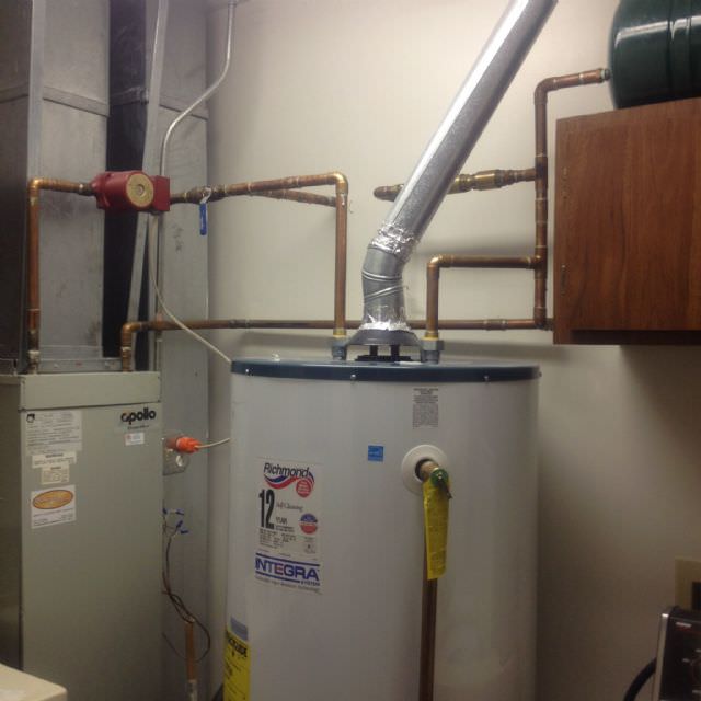

My advice? Go with a larger-than-you-think-you-need water tank with a longer-than-you-think-you-need warranty. PAN EVERYTHING, even under the air handler. (You'll find leaks more quickly & easily this way.) Go with a larger expansion tank than you need, too.
On the expansion tank, I don't know what the law is in other states, but to be up to code in IL, you need to have a back double check valve installed. That requires an expansion tank so the water has somewhere to go when the heated molecules expand (since that valve prevents the expanding water from going back into the external water source). I replaced my expansion tank last year because the bladder went (causing the temperature release valve on the water heater to do its job several times a day). If you are doing any new work, make sure you're getting up to code while you're at it.
I've included a picture of my piping below.
Hope this helps!
-- jmk
*In addition to panning, I have a funnel under the water heater's release pipe that's connected to a vinyl hose that leads straight to my drain. thus eliminating rusting of the outside of the tank. (It took me a while to get the new expansion tank installed since I needed to find someone to sweat copper for me [because the new tank was taller].)

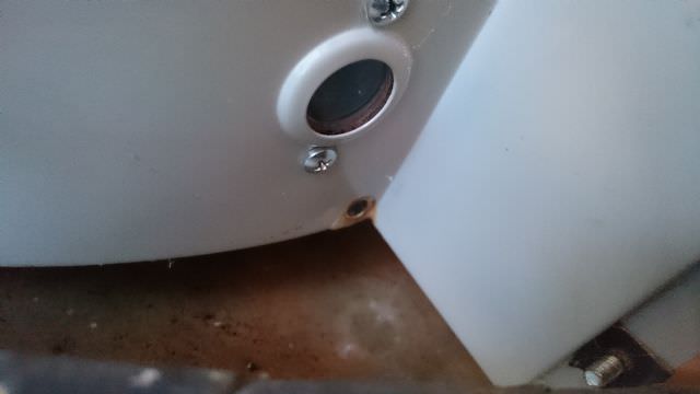

Hello all!
This is a great thread and I hope it continues considering there's lots of older homes with this heating system. Anyhow! Getting a bit colder here in Durham so I raised the temperature of the water heater as pointed out to us by previous owners of the house we bought it from. Nifty system but wish ours was set up better in the townhouse (WH in "shed" out back and heat exchanger/blower in closet towards the front). Blah getting sidetracked, I noticed that there was a leak on the bottom of the water heater (State Select WH) and that there was actually water leaking out of it from a panel on the bottom. I've called around and keep getting quoted 1500+ to fix even though from what I've read, it's just a matter of replacing the water heater if there's nothing else wrong with the system right? And yeah it's a big IF and I understand that cheapest is not the best way to go with this considering it's a pretty big part of the house but $1500+ is a big chunk of change...
Here's a picture of the leak (panel under the thermostat control/pilot lighter) -

Find a tech who knows how to work on these systems. Ask him to confirm that the water heater is actually leaking and that you're not just seeing condensate. The ask him to carefully examine the coil at the air handler to see what kind of shape it's in. If it's in good shape and the water heater is really leaking, then get a new tank installed. $1,500 installed seems a tad high, but not a whole lot.
