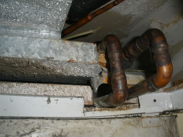

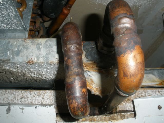

Ryan Guy Posted May 22, 2013 Report Posted May 22, 2013 Hey all. I'm having a problem with a leak coming from the condenser drainage pan of my Apollo AC system. The leak occurs when the AC has been running long enough for the pan to fill up completely. At this point it seems to spill over at a very slow trickle from the top of what I am assuming is the primary drain pipe. There is a second pipe set to the left and slightly above the main pipe, and I am assuming this is an emergency/overflow drain. If I turn the AC off when the pan is full/leaking, then the water will recede to the level of the bottom lip of the left (overflow?) pipe and stop. At this point there is no more leak, but the remaining water in the pan will not drain. My questions: Do I have the mechanics of this system correct? Is the right-side pipe blocked in some way that is preventing drainage? If so, is there anything I can do to fix the problem? Thanks for any help you guys can offer. I will include some pictures of the pipes below. Click to Enlarge 56.46 KB Click to Enlarge 56.99 KB
Marc Posted May 22, 2013 Report Posted May 22, 2013 That's a lousy install. The copper drain lines intrude into the space provided for the air filter and copper is a lousy choice for 3/4" condensate drain lines because the lines need to be removed occasionally for cleaning. I'd say your primary drain line is clogged and the emergency overflow has been effectively draining the pan for so long that now it's becoming clogged too. You might have a dirty evaporator (cooling) coil or Apollo heat exchanger. That would clog them right quick. Remove both drain lines and clear them. Give the evaporator coil/heat exchanger a visual inspection. You shouldn't attempt to remove the drain lines yourself because the pan might be corroded to the point where the connection to the drain line will simply snap off like popcorn once you torque the drain connection. Replacing that pan is often times a pain-in-the-neck, involving the recovery of the refrigerant and removal of the evaporator coil/heat exchanger. Marc
