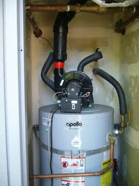

Hello...I just moved into a condo that was constructed in early 2006. It has an Apollo Hydronic system. My issue is that there is an exhaust fan sitting atop the HW tank (I am told to draw excess heat off the tank per the HOA manager) that comes on for maybe 90 seconds every hour or so. It creates a loud turbine sound in the HW tank closet next to a bedroom. I intend to attach maybe 8 to 10 feet of 4 inch flex line to the air intake to muffle it down (hopefully that is okay), but it exhausts right over the window of another bedroom...fairly loudly. I assume this fan is necessary?
And from what I read here, to replace this system one day would require not just $$, but a change of ducting etc?
I have attached a photo. Thanks for any insight. Tim

Chances are the fan itself is bad. It should be very quite while operating.
I don't know what a "turbine" sound might mean to you, but if it is what I would call a rotating noise,perhaps a high pitch screeching the impeller is most likely hitting the case as it operates.
While it is operating put your finger lightly on various places around the motor mounting screws or case. Do you feel a vibration in your finger. Replace the draft fan assembly.
Posted
Thanks for the reply. The fan is not screeching; I have put my hand on it when it is running and do not feel and bad vibration either. The air intake is only 3-4 inches long and opens to the back of the closet...so the turbine sound appears to be coming from the fan simply drawing air at high speed (I can muffle it with my hand by closing it slightly). That is why I think I can muffle it in the closet by attaching a good length of 4 inch wide hose running into the bottom of the closet. But I cannot do the same for the exhaust end, though the long intake draw may tend to quiet it some as well.
What is this fan for? Bleeding off excess heat? A normal HW tank does not have such a fan.
