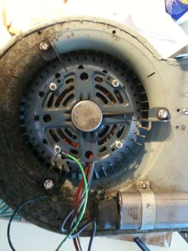

matsam Posted January 30, 2010 Report Posted January 30, 2010 I have an Apollo Hydroheat system that has never worked very well, but this might be in part due to poor ductwork-- several rooms of my 1500sqft townhome can barely feel any airflow from the vents when the fan is running. Anyhow, now the motor on my unit appears to be dying. When it turns on, I can hear it humming, and often it tries to spin the blower, before it grinds again to a halt, still humming, trying to make it turn. The first few times it happened, i manually spun the fan and it then resumed operation as normal. I got the run capacitor checked, and it is within normal limits, and the guy at store said the motor was bad. I then took the unit to several HVAC vendors in town, and all said i have nothing that small here. The final guy I took the motor to actually called up his supplier, who said that because Apollo was out of business, it would be impossible to replace, and that there wasn't any proper substitute for this motor. In part, it seems they thought that the built-in bracket on the motor would be hard to match. In examining the motor and blower, it seems as though a larger motor would fit in squirrel cage, and that the cage has holes for mounting a different kind of bracket, if need be. Therefore, my question is--- should I try a different motor model in my unit? How can I be sure the electricity requirements are acceptable? Are electricity, bracket-mounting, and size of motor the 3 main concerns? Here are the details of my current motor: Make: GE Model: 5KCP29JK4850S (the # 4850 is also stamped on the unit elsewhere) V. 115, RPM 1075, Hz. 60, Amps 4.06, Hp 1/4, Cap. 10.0mfd/370V, Ph.1 Diameter of motor is 5", diameter of the "hole" of the squirrel cage is 8", or so. If this unit seems to be non-replaceable, can anyone advise just how much of my unit will need to be replaced? Can I just replace the cage/blower/fan, or will I have to do more of that because of the electric requirements? Other parts in this system in include a Grundfos unit, and Taco pump, and condensor coils (i think?). I saw a rubber tube coming out of the motor, and squirted some WD-40 in there, hoping to help things, but that didn't seem to do much. The fan seems to turn easily when the motor is shut off. Thanks in advance for any replies! I have several pictures of the unit if those would facilitate things. -Mat Click to Enlarge 76.1 KB
Tom Raymond Posted January 30, 2010 Report Posted January 30, 2010 Graingers probably has a motor that will fit that blower, but it would surprise me if they didn't have that exact model. They sell wholesale, so you may not be able to buy directly from them but their site is searchable. If that fails you could always have your motor rebuilt. Find an electric shop that specializes in industrial or construction equipment, or a shop that rebuilds automotive electrics like starter motors. It may take a few days but rebuilding is often less expensive than replacing, and Durham is usually warm enough to go a few days without heat although you wouldn't know it from this winter. Tom
matsam Posted January 30, 2010 Report Posted January 30, 2010 Thanks for the reply, Tom! I think I'd prefer to replace the motor entirely, I couldn't find my model at Graingers, but there were a couple similar GE ones, notably missing the welded-on brackets that my model has. The unit they have is also a wider diameter (5 5/8), though I don't know if that is crucial. My cage seems like it could handle that size well enough. The shaft diameter seems pretty key, but I haven't measured mine. If the shaft diameter matches up, are there any specific electric parameters I need to be aware of? Any other parameters as I try to find a 'good-enough' replacement? The one I'm looking at on Grainger has these specs: Direct Drive Blower Motor, Permanent Split Capacitor, Open Air-Over, 1/4 HP, Nameplate RPM 1075, Voltage 115, Full Load Amps 4.2, 60 Hz, 1 Phase They seem pretty similar to mine, but maybe I'm missing some crucial point here. Assuming I can find a way to mount it to my cage, will it be as simple as wiring up the white/black/red cables as on my current setup, and getting the capacitor in place? Thanks!
Tom Raymond Posted January 30, 2010 Report Posted January 30, 2010 Besides the shaft size and mounting considerations you will want to closely match the RPM. Spin too fast and the coils will cool too quickly or the air will move too fast to gain heat as it passes the coil and it could be noisy, too slow and you will not move a sufficient volume of air to heat the house. Also if given a choice, take a more powerful motor. 1/4 HP is probably fine, but 3/8 or 1/2 will last longer and comparably priced. Tom
hausdok Posted January 31, 2010 Report Posted January 31, 2010 Take it to an electric motor shop. Those guys usually have every kind of motor imaginable. Back in '73 I did a short stint as a maintenance guy in a factory in Torrington, CT and we were constantly replacing electric motors or getting them rebuilt and I often visited a local electric motor shop. Bet they can help. I once picked up a really old chest freezer that somone had kicked to the curb. I took it home, plugged it in and discovered that the motor was burned out. I removed the motor, drove downtown to an electric motor shop and asked 'em what it would cost to rewind the motor. They guy glanced at it, said, "No need, I've got a half dozen of those around here someplace," and disappeared into a back room stacked floor to ceiling with electric motors. About five minutes later he emerged with an exact match. He sold it to me for $15 'cuz he'd never had a call for one, and I installed it in that freezer. I kept that danged thing for years and finally gave it away to another GI. ONE TEAM - ONE FIGHT!!! Mike
matsam Posted January 31, 2010 Report Posted January 31, 2010 Two votes now for the motor getting rebuilt-- looks like I will try to find a place on Monday! Thanks all, for the advice! -Mat
