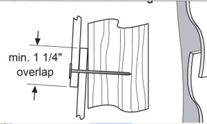

Brandon Whitmore Posted September 23, 2008 Report Posted September 23, 2008 Can anyone tell me why they specify 2 nails per stud for face nailing under note w, while requiring only 1 nail per stud for concealed fastening? This is in regards to fiber cement lap siding......... Thanks,
Brandon Whitmore Posted September 23, 2008 Author Report Posted September 23, 2008 Also, where would you place the second nail per stud? I noticed this note on James Hardie's installation instructions: Face Nailing should only be used where required for high wind areas and must not be used in conjunction with Blind Nailing I'm trying to think of one installation where no face nails were installed when the system was blind nailed. Doesn't that mean that we should see no face nails anywhere in the system (when blind nailed as is typically the case)?
hausdok Posted September 23, 2008 Report Posted September 23, 2008 Hi, Unlike wood siding, where, due to expansion-contration concerns, when you face nail you want the nail to miss the top of the clapboard being overlapped, with fiber-cement siding when you face nail it each clapboard is penetrated twice - once near the top and once just above the drip edge - sort of like how the top 2 inches of a correctly-nailed comp shingle gets secured. Face nailing should only be done in high-wind areas. You see the face nail on the bottom of the clap and that nail is the second nail that secures the top of the one that clap overlaps. Image Insert: 13.67 KB ONE TEAM - ONE FIGHT!!! Mike

Brandon Whitmore Posted September 24, 2008 Author Report Posted September 24, 2008 Face Nailing should only be used where required for high wind areas and must not beused in conjunction with Blind Nailing I'm trying to think of one installation where no face nails were installed when the system was blind nailed. Doesn't that mean that we should see no face nails anywhere in the system (when blind nailed as is typically the case)? I'd love to hear an answer to this one.......... Mike, don't make me look stupid again.....
hausdok Posted September 24, 2008 Report Posted September 24, 2008 Hi, Well, when the system is truly blind nailed you don't see the nails...period. I had two houses last week like that. I see them all the time. I also see the ones that are meant to be blind nailed but where the installer can't get the stuff to lie flat and resorts to face nailing here and there. The trouble with this system is that lots of folks don't bother to install a starter strip behind the bottom course and somewhere on the wall they'll end up with a course that's a fraction of an inch too low. This causes the bottom edges of the low course, particularly at the butts, to lever away from the face of the underlying clap and the only way that they can get them to lie flat is by face nailing the bottom corners on both side of the joint. Some guys drive a single nail in between the two claps at the butt to hold them flat instead of using two. When the stuff is installed right it will either be all blind nailed or all face nailed. It wouldn't be necessary to do it both ways if folks would bother to read the instructions and install the proper thickness of starter course at the bottom of the wall. ONE TEAM - ONE FIGHT!!! Mike

Brandon Whitmore Posted September 24, 2008 Author Report Posted September 24, 2008 You will also not have a smooth/ flat wall plane with bowed studs, etc. which holds out the siding. Seeing as how the manufacturer says "do not face nail", I was curious as to your thoughts regarding adding some face nails. I'm also wondering why they specifically state that face nails should "not" be installed-- what can happen. It seems like adding face nails is a pretty common repair when siding is improperly fastened. Siding slowly loosens up and can slide down when nails are over- driven. Seems to me like adding face nails should be an adequate repair, but maybe not.....
hausdok Posted September 24, 2008 Report Posted September 24, 2008 Hi, Actually, they say, "Face nailing should only be used where required and should not be used in conjuction with blind nailing." I think the reason they don't want folks face naililng along with blind nailing is that once the weather/temperature changes those tacked butts will stick out like sore thumbs. If the whole thing is face nailed then you don't see big differences from one area to another in how claps react to those changes. That's my theory and I'm stickin' to it until someone proves I've got my head tucked up my butt (Well, I do anyway, but that's beside the point). ONE TEAM - ONE FIGHT!!! Mike
