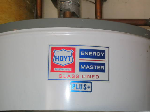

crusty Posted May 30, 2004 Report Share Posted May 30, 2004 Actually I've found a wide range of quality. This brand is legendary. I regularly see this. 26 years old and going strong. They made a copper lined unit that I have seen going strong at 40+ years old. Download Attachment: 130_3096.JPG 35.26 KB Link to comment Share on other sites More sharing options...
