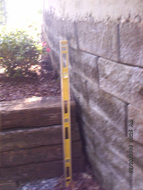

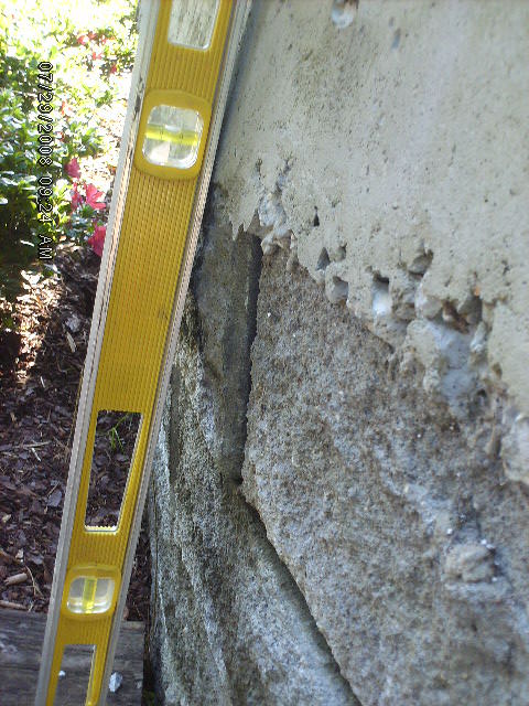

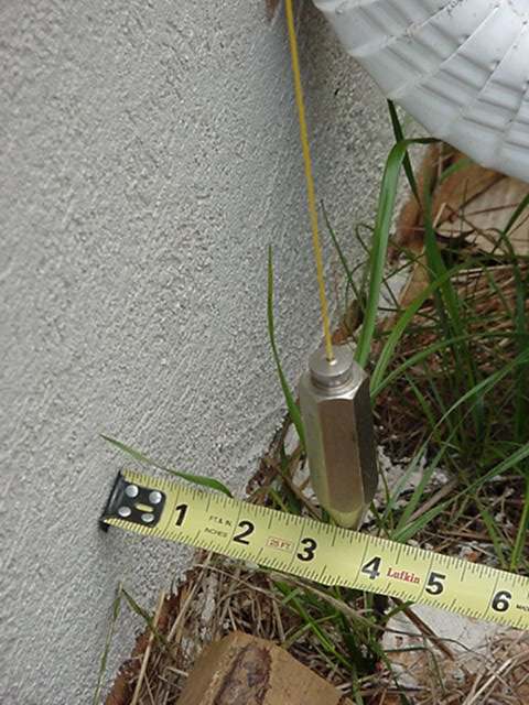

Posted
Battle of the Bulge!
See below off vertical measure of seven foot high wall made of CMU.
Image Insert:
82.5 KB
Fix was performed years later by building an engineered wall about seven feet away, then filling with soil to create apprx forty foot long "planter box".
