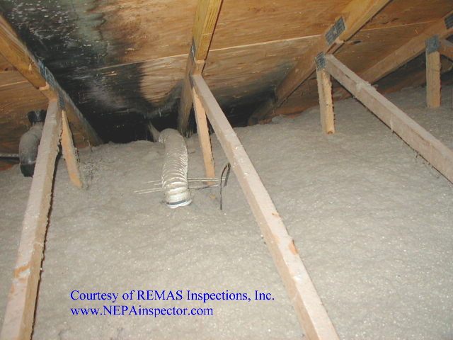

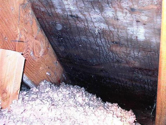

You also need to be careful about what's directly overhead. I've never personally seen vents that exhaust out the side of a house cause any attic issues, but others who've posted here have posted pictures of some serious moisture-related issues involving vents that discharge outside of sidewalls beneath the eaves.

IRC M1501.1 Outdoor discharge. the air removed by every mechanical exhaust system shall be discharged to the outdoors. Air shall not be exhausted into an attic, soffit, ridge vent or crawl space.

Doesn't the new 2006 IRC require bathroom vents (such as this) to actually vent outside and does not allow these to vent just at the soffit? In other words, instead of the vent terminating just inside the soffit, I believe the new 2006 IRC requires the vent to terminate PAST the soffit (literally now outside) to prevent mold growth on roof sheathing, etc.
