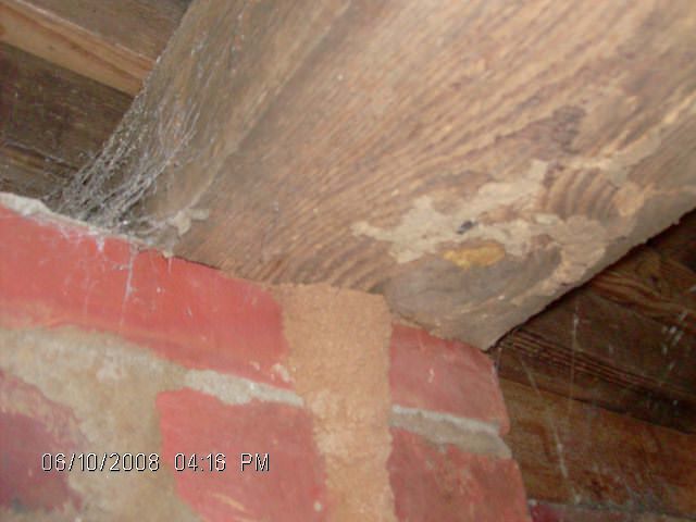

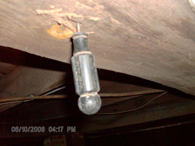

Phillip Posted June 11, 2008 Report Share Posted June 11, 2008 Here are the largest Termite tubes I have seen. Yes they are active. Image Insert: 105.3 KB Image Insert: 114.38 KB Image Insert: 101.54 KB Link to comment Share on other sites More sharing options...
Brian G Posted June 11, 2008 Report Share Posted June 11, 2008 In a hell of a coincidence, I found the biggest termite tube I've ever seen today. It looks very much like the one in your second picture, except that......well, mine's bigger than yours. [] Image Insert: 119.27 KB Are termites getting bigger, or just more ambitious? Brian G. Now Open, Termite Toll Tube! [] Link to comment Share on other sites More sharing options...
