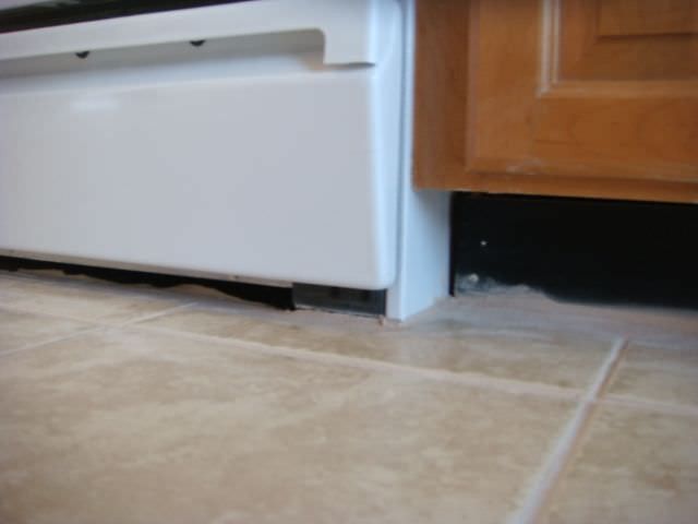

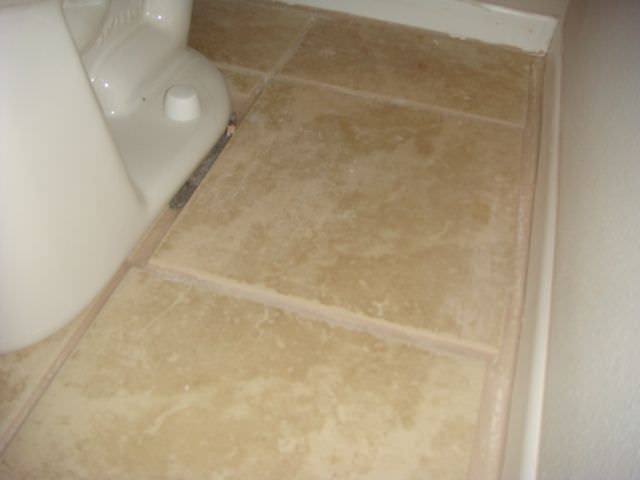

mridgeelk Posted June 4, 2008 Report Posted June 4, 2008 The grout job speaks for itself. (the electric range is grouted in place) Should this tile have had underlayment other than the particle board subfloor visible under the leaky tub? Image Insert: 118.78 KB Image Insert: 104.13 KB Image Insert: 99.4 KB
Mark P Posted June 4, 2008 Report Posted June 4, 2008 Yes, there should be some brand of cement board. I can't tell from the pic what the subflooring is, but if it is particle board like you say, the tiles may not stay attached very long.

steven meyer Posted June 4, 2008 Report Posted June 4, 2008 Manufactured or modular, the floors are usually of poor structural integraty. This looks like a do it yourself home owner job, as most tile setters would have pulled out the stove and tiled under it. In most probability, tile was laid over what ever floor was there, and possibly with mastic. Thus, poor/inproper istallation, springy floor, would cause lose tiles and the grout to crack. Proper method of tile installation: 1. over lay floor with 1/4 inch cement board, with thin set and screwed down. 2. Install floor tile with thin set. Due to structural issues with these types of "homes" I am not a big fan of installing tile.

StevenT Posted June 5, 2008 Report Posted June 5, 2008 Definately looks like a DIY to me. The moulding should have been removed and replaced after tiling. The cuts are extremely uneven, as are the joints. Also, the area by the Johnny bolt that is missing grout and seems to be missing tile is shoddy and will leak. The bowl was not set in plaster or even siliconed in. It won't be long 'til that bowl is loose... and leaking.

mridgeelk Posted June 6, 2008 Author Report Posted June 6, 2008 My client backed out of the deal today after a a very experienced tilesetter evaluated the home. He said that even the type of grout was wrong. Originally posted by AHIS Yes, there should be some brand of cement board. I can't tell from the pic what the subflooring is, but if it is particle board like you say, the tiles may not stay attached very long.
steven meyer Posted June 6, 2008 Report Posted June 6, 2008 Don't know what he is referring to as the "wrong type of grout". The grout job is only as good as the tile job. If the tile is not stable, then movement of the tile (however slight) will effect the grout. There are modified grouts out there, but those would not have solved the poor tile setting job. Guess your only option is to rip it all out and install the tile correctly. The good news is: It was such a poor job, the old tile should come up fairly eaisly!!! Good Luck
mridgeelk Posted June 7, 2008 Author Report Posted June 7, 2008 He said that the grout was of the non-sanded type which should not be used in spaces larger than 1/8". He said that it was likely the worst setting job he ever saw and should be completely redone. Originally posted by steven meyer Don't know what he is referring to as the "wrong type of grout". The grout job is only as good as the tile job. If the tile is not stable, then movement of the tile (however slight) will effect the grout. There are modified grouts out there, but those would not have solved the poor tile setting job. Guess your only option is to rip it all out and install the tile correctly. The good news is: It was such a poor job, the old tile should come up fairly eaisly!!! Good Luck
steven meyer Posted June 7, 2008 Report Posted June 7, 2008 He is correct in that. Sanded grout should have been used for that application. It is obvious this was a do it yourself job, guy didn't even take the time to take a homd depot free class, and probably took the "advice" of the 18 year old kid. I have had HD customers ask me what/how to use with tile when I am picking up tile supplies for myself. So, looks like you are going to need a new floor. No way to fix/salvage what ya got now!!!!
