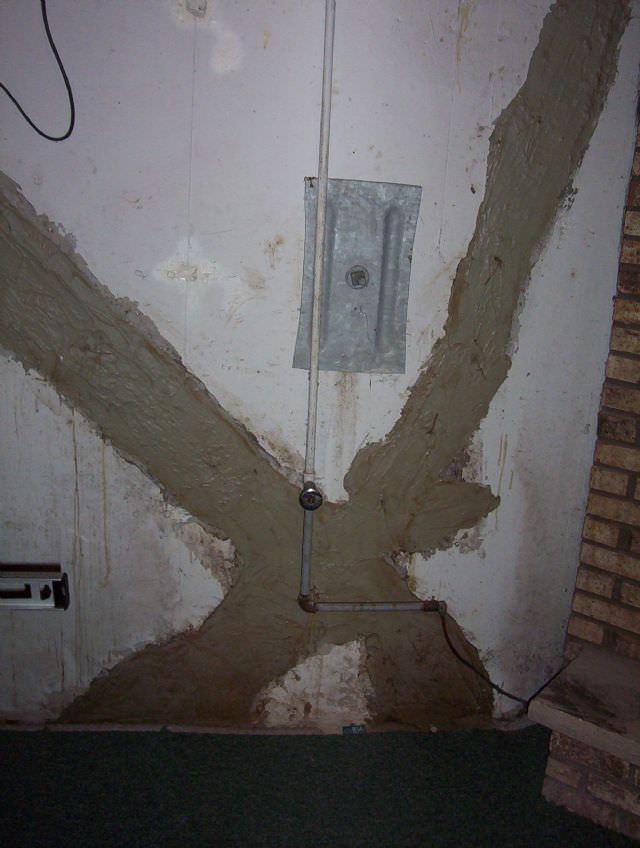

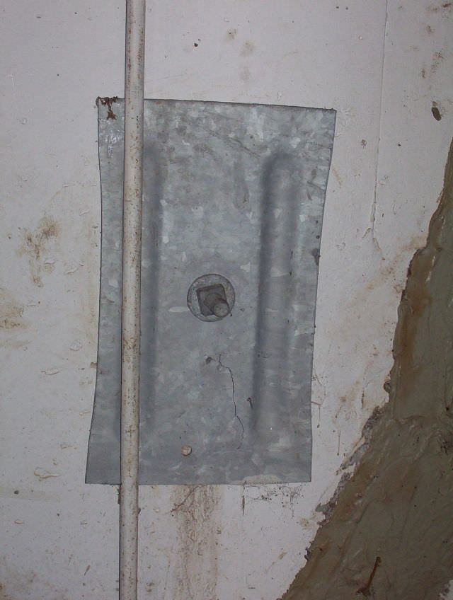

Mike Lamb Posted May 17, 2008 Report Posted May 17, 2008 This plate looked bolted through the foundation. Why do you suppose it's there? 30 yr. old home. The "X" patch did not look like a structural concern to me. No bulging to speak of. No problems inside or out to suggest important foundation failure. Image Insert: 397.26 KB Image Insert: 393.53 KB
Kyle Kubs Posted May 17, 2008 Report Posted May 17, 2008 Looks like the inside end of an earth anchor to me. Ugliest patch job I ever saw too.
jon_ran Posted May 17, 2008 Report Posted May 17, 2008 Foundation stabilization to an earth anchor in the yard.
Rob Amaral Posted May 17, 2008 Report Posted May 17, 2008 Ditto on the earth anchor as well. Was the house built on a sloping lot? R
hausdok Posted May 17, 2008 Report Posted May 17, 2008 The wall got pushed inward and cracked - frozen fill or clay - they excavated, pushed it back to where it needed to be, backfilled it properly while adding the anchor, and then patched the wall. OT - OF!!! Mike
kurt Posted May 17, 2008 Report Posted May 17, 2008 See if it was Dave Pate & Sons that did the work. If it was, that's a Chance Systems earth anchor.

Mike Lamb Posted May 17, 2008 Author Report Posted May 17, 2008 Thanks. The patch is holding out water and the anchor is holding up best I can see. The grade is good. House is on a little hill. Maybe the foundation got smacked by the dozer when they were back filling.
Mike Lamb Posted May 22, 2008 Author Report Posted May 22, 2008 Grip-Tite has a good video to illustrate this anchoring system. http://www.safebasements.com/grip_tite_w.php
