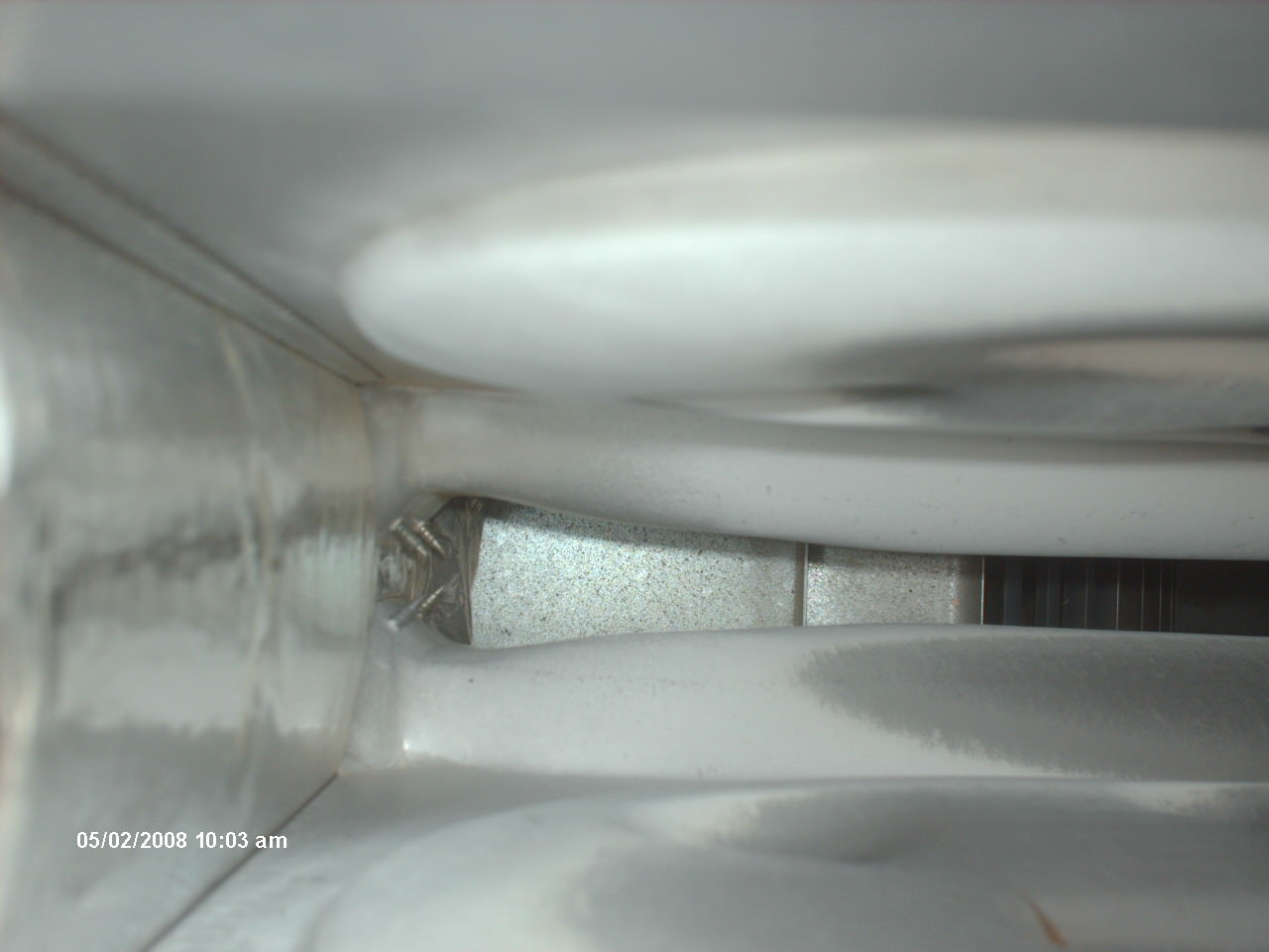

The flame indicated to me a breach in the heat exchanger. The homeowner & their agent tried to discredit me as not qualified. Well, it appears the HVAC technician confirmed my suspicion. I had an opportunity to return during the installation of the new unit and get a few more photos for my collection. There were a few other visible cracks. icon_speech_yeah.gif
