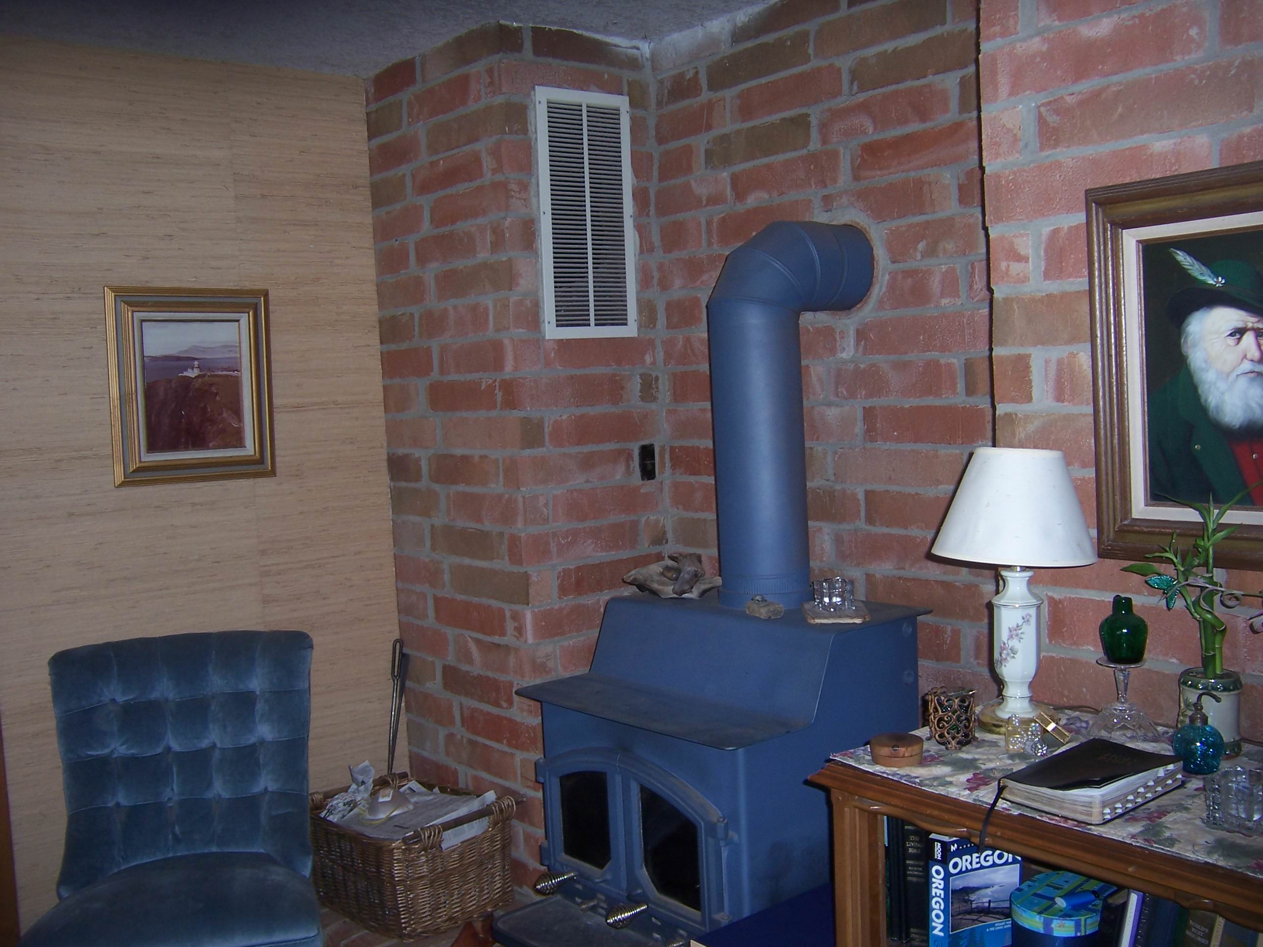

Brandon Whitmore Posted April 30, 2008 Report Posted April 30, 2008 2006 IRC: Does M1602 Exception 2.3 apply? I am looking for a reason to write up this furnace return air duct above the wood stove. It is one of 3 return air ducts in the home for a new electric funace install (older return air). The house was built in 1978. Image Insert: 70.77 KB
Brandon Whitmore Posted April 30, 2008 Author Report Posted April 30, 2008 Sorry-- having trouble uploading the image Image Insert: 987.33 KB
Bill Kibbel Posted April 30, 2008 Report Posted April 30, 2008 I think the concern would be if it was the only return opening, then it needs to be 10' or more from the stove. There's lots of returns near stoves around here - on purpose!
