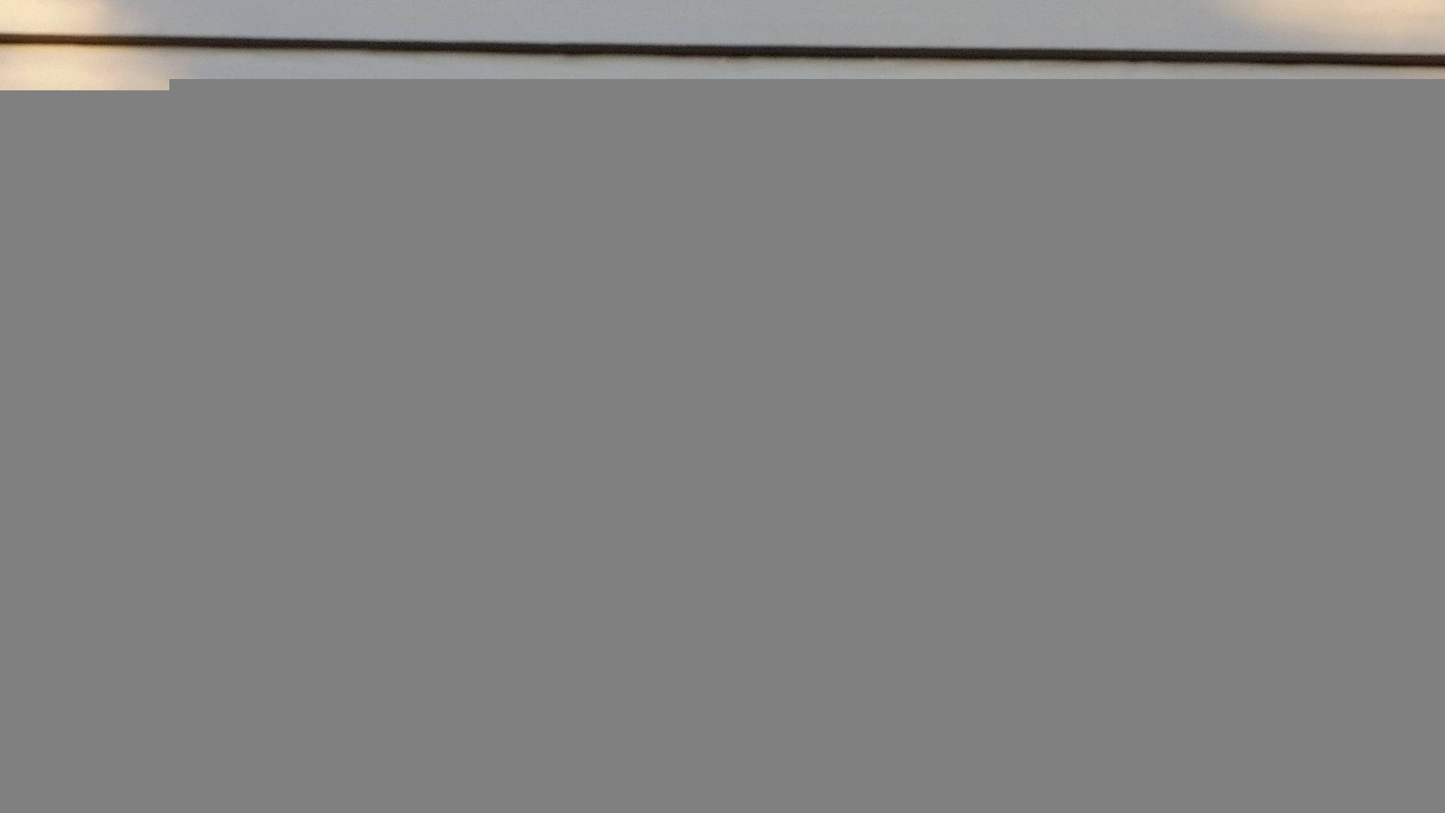

robsha Posted February 22, 2015 Report Posted February 22, 2015 I know this post is pretty old but I have some questions about the Hardie Plank on my house the last 2 years I have been noticing some sort of brown dripping from under my siding. I live in Washington and this is on the south side of my house that gets most of the weather. Can you guys tell me what is going on here? Thanks Download Attachment: 20150221_161222.jpg 757.6 KB Download Attachment: 20150221_161236.jpg 762.24 KB Download Attachment: 20150221_161244.jpg 622.91 KB
Jim Katen Posted February 22, 2015 Report Posted February 22, 2015 I know this post is pretty old but I have some questions about the Hardie Plank on my house the last 2 years I have been noticing some sort of brown dripping from under my siding. I live in Washington and this is on the south side of my house that gets most of the weather. Can you guys tell me what is going on here? Thanks Download Attachment: 20150221_161222.jpg 757.6?KB Download Attachment: 20150221_161236.jpg 762.24?KB Download Attachment: 20150221_161244.jpg 622.91?KB Is there a bathroom on the other side of that wall?
robsha Posted February 22, 2015 Report Posted February 22, 2015 No bathroom 2 bedrooms on second floor and office and family room on 1st floor.
robsha Posted February 22, 2015 Report Posted February 22, 2015 There are 3 wood wrapped windows on that side of the house. there is some cracking which has been sealed with caulk and I have had 2 boards that that the nails in the upper corner has just broke at the nail and the board slipped sown about 1/2 inch. Looks like the corner nails were installed correctly within the hardy guidelines in this spec. (http://www.jameshardie.com/d2w/installa ... -ca-en.pdf).
Jim Katen Posted February 22, 2015 Report Posted February 22, 2015 I don't know. Pull off a plank or two and look at what's going on behind them.
mark parlee Posted February 22, 2015 Report Posted February 22, 2015 Get us some elevation photos of the entire side of the house where the problem is showing up. Where at in Washington and what is the climate zone? Have the last two winters been a lot colder than the previous ones in the last ten years? What is the wall sheathing material? Is there a WRB (weather resistant barrier) between the siding and the wall sheathing? If so do you know the brand of the WRB?
robsha Posted February 25, 2015 Report Posted February 25, 2015 Hello Mark, just saw your mail. We have actually had fairly mild winters in Olympia Washington compares to others. I am pretty sure there is Tyvec for the WRB. I will try to get pics during the day and post back when I can. Thanks Robert
hausdok Posted February 26, 2015 Report Posted February 26, 2015 My guess is that the butt joints are neither splined, in substantial contact with one another or sealed with caulk and that the underlayment is black building paper - which is very common here - and what you're seeing is some weeping of the paper. If that's the case it might be caused by the asphalt paper weeping behind the siding.

robsha Posted September 5, 2016 Report Posted September 5, 2016 There are 3 wood wrapped windows on that side of the house. there is some cracking which has been sealed with caulk and I have had 2 boards that that the nails in the upper corner has just broke at the nail and the board slipped sown about 1/2 inch. Looks like the corner nails were installed correctly within the hardy guidelines in this spec. (http://www.jameshardie.com/d2w/installa ... -ca-en.pdf). OK finally had a contractor look at our issue it appears that the original builder never flashed the windows in our house. So the side we were having the issues with there was water finding it's way under the siding. We had to replace the siding on the whole side of the house problem solved unfortunately it was very expensive. Luckily there was only a small portion of the OSB underneath the tyvek that needed replaced.
mark parlee Posted September 5, 2016 Report Posted September 5, 2016 How old is the house. Most states have a 10 year statute of repose for construction defect damages, 15 in my state. If you just had it fixed and did't document the damages you probably would have a tough time in presenting a case. If it was done wrong on one side then it is probably done wrong on all. The problem may appear later if it hasn't already on the other sides of the home. Here is an article hat might be somewhat pertinent to you Download Attachment: Common siding Failures wc_JLC_Siding_L.pdf 1657.47 KB
robsha Posted September 6, 2016 Report Posted September 6, 2016 Mark, House was built in 97 and yes none of the windows were flashed correctly. We are the second owners so we probably would not have had much recourse with the builder. I have actually fixed 2 other windows that are on weathered sides of our house. The rest of the windows do not get the weather so we are not worrying about those.
mark parlee Posted September 6, 2016 Report Posted September 6, 2016 Robsha Thanks for the additional info. Too much time has passed to do anything. as I said in my state it's 15 years but even that has passed in your situation. Also here it does not matter that you are one of the successive owners, you could be the 10th owner and still have recourse as long as the time was right. You best course of action is to do the repairs and corrections. Do you have anyone you trust that could do an in-depth review and analysis of your house on the other areas that are not yet corrected, it may surprise you what you find? To be fair I look at many houses that do not have the windows flashed properly and they do not have problems yet but it is only a matter of time, in most cases.
