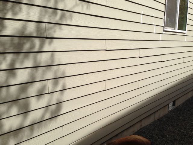

I had a feeling my question would bring out a range of responses, based on what I had already read in this thread. :)
Mark, if I had it to do over again I might think twice about buying a house with Hardiplank, or would at least have taken a closer look at the installation. In fact, if I had it to do over again I would not buy an Arbor house at all. But under the circumstances, I'll settle for making it reasonably right. Completely right is probably not going to happen, as it sounds like a great deal of work and expense.
I guess it could be worse - we have none of those golf ball dimples you show in your pictures, nor any of the cracked planks that are in some of the other pictures in this thread. There are one or two places that might be spalling as you said, but they are way up high and I won't be getting a good look at them for a few months yet (we will need to rent or buy a ladder to get up there). From the ground it's hard to tell if the end of the plank has swollen or flaked or something along those lines or if it has warped and is bending outward slightly.
We are not super handy people - every thing we tackle is a new journey of discovery, as they say. I kind of enjoy this kind of work as long as I have a clue of what I'm doing; my husband hates it, so things tend to get put off until they have to be done. Neither of us has ever painted the exterior of a house either, but at least that is easy to research online. The only reason we're doing that is the HOA is requiring it this year.
So, having said that - Kurt, what do you want to see more pictures of? Those two sagging boards are the worst; there are maybe 5 - 6 of them total. It looks like it's only happening in one relatively small area, I believe all below 6' off the ground. My hunch is that the guy who installed the planks in this area was even less knowledgeable than usual and did something wrong, but I have no way of knowing.
I am ok with not having a perfect installation, but I'd like to correct the most egregious problems and at least make it look nice.
I mentioned that Arbor gets sued a lot. They have actually been sued by many of our neighbors, and the suit is just settling now. The main issue was that they didn't install the Tyvek moisture barrier properly, but lots of other defects were noted along the way. We didn't participate in the suit because we aren't the original owners and so would be entitled to less compensation, and since the legal expenses were to be divided evenly among all the homeowners we were concerned about getting very little or even ending up owing them money.
We did have Forensic Building Consultants do the preliminary evaluation on our house. They found lots of defects but did not find the major mold and rot issues that some of our neighbors had. A number of the smaller homes in this development have had to have nearly all the siding replaced; interestingly the larger, more expensive homes like ours seem to be better built and have more minor issues. So, given our second owner status and the lack of major problems, we thought it too risky to join the suit.
I just found the report, which had this to say about the siding:
- Inadequate clearance at siding terminations or interfaces with adjacent building components, including the following location(s):
o Less than 3/8" clearance between siding and metal flashing at horizontal terminations
o Less than 1/4" clearance between siding and vinyl fenestration frame
o Less than 2" clearance between siding and horizontal paved surface
- Improper siding fastener schedule, including the following condition(s):
o Lap siding planks fastened less than 3/4" from plank top edge
o Siding not adequately secured to underlying structure (evidenced by deflection of lap siding planks)
- Greater than 1/8" width of lap siding plank butt joints
So there you go. Have I mentioned that Arbor is a crappy builder? :)
Does anyone think I should be getting in touch with James Hardie? Or is 10 years out just too long for anyone to care about installation problems, no matter how bad?
Let me know what additional info or pictures you guys (or any one else) would like to see and I will provide them ASAP. Thanks very much for taking the time to respond!

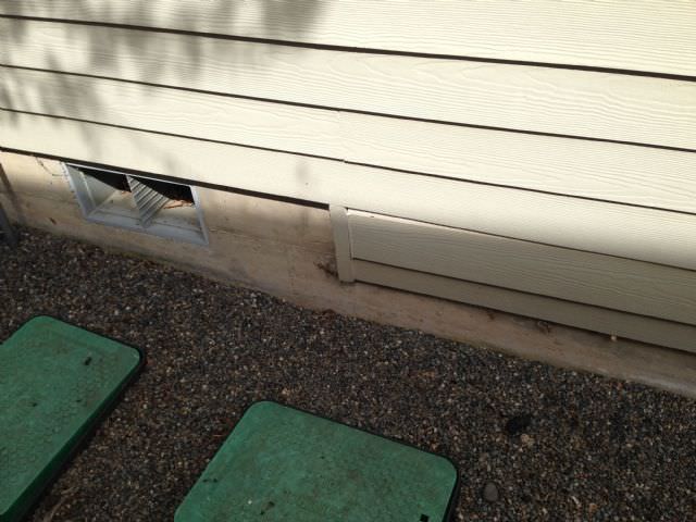

. . . However, there's one section of siding, on the west side of the house, where some of the pieces appear to have slipped. Representative pictures below. They aren't loose, in fact they don't move at all when I try to wiggle them. One of them has a visible nail hole with no nail in it (not torn out).
Can anyone please tell me:
- what the heck happened here?
The nail was overdriven. It's still attached to the sheathing, but the siding plank has slipped down. It can be lifted back into position and face nailed to hold it there.
- how do we fix this with a minimum of removing and replacing?
- are there any good homeowner references out there on how to work with this stuff? I presume we probably would not understand the official installation instructions nor have the correct tools to follow them.
The instructions are readily available online. They should be easy to understand.
is there any point in contacting James Hardie after 10 years? We are not the original owners of the house and have no idea what the warranty is on this stuff.
The overdriven nails are a poor installation issue. They don't warranty that.
Further, since we are going to have to touch every single joint on the house, is it worth our while to try to install flashing under the joints? Is this a homeowner-level task? Smearing on caulk sounds easier but I don't want to be up there again in a couple of years (did I mention it's a two story house? :)
Forget about the caulk. Someone (you, if you have the skill) can easily slip flashing up behind each joint. You'll need flashing pieces that are the same depth as the exposure of the siding. Just use tin snips to clip each side of the flashing 1" up from the bottom on each side and slightly bend back the flashing just above the cuts to form little "wings" that will cause the flashing to snap into place when you slip them between the siding pieces.
By the way, you might only have to put flashing behind the joints on the south and the west sides. In our area, the caulk joints on the north and the east sides often fare just fine.
Thanks in advance to anyone who can offer advice or pointers to other information. This task is completely new to us so we have a *lot* to learn.
It's not rocket science, but it can get tedious.

I'm not sure how much these are going to help - I may have to get ahold of a real camera instead of using my phone. But here's what I have for now. The first picture, with the window far away, is what it looks like from the corner of the house (which is just outside frame to the left). The next picture, closer to the window, is the next part of that side of the house. You can see (I hope) where the slipping boards stop. The last picture is a bit more context for the worst one, the one with the visible nail hole.
The caulk marks around the window were made by Forensic; they opened up the house in a few places to check for water damage and the kitchen window was one of them. They caulked the areas they worked on and replaced a few pieces of siding (presumably ones they had to destroy to get the opening started).
Do these help at all?

Is it possible those planks were pried loose by the Forensic investigators? I think you should check around and see if neighbors have similar damage. Then you could all go after the perpetrators.
