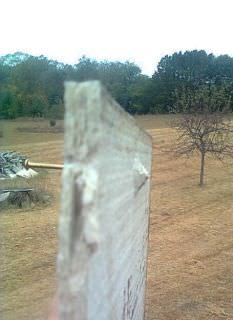

gtblum Posted September 13, 2012 Report Posted September 13, 2012 Click to Enlarge 14.54?KB Hold on one minute. Until you can take that same piece of siding, lay it against something like a sheet of OSB or anything else it would normally be fastened to in a real world application, and produce the same result, you've got nothing. You could do the same thing to a sheet of plywood or a 2x4, with a nailer. Will I still install it? Yes, because Hardie spends so much money on advertising it can't be avoided. Really? So, are you saying that even though you believe this product is junk, you'll do anything for a buck?

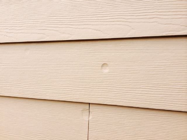

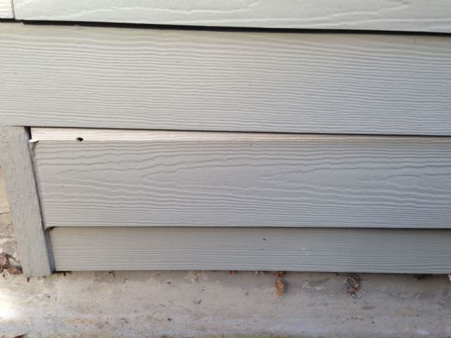

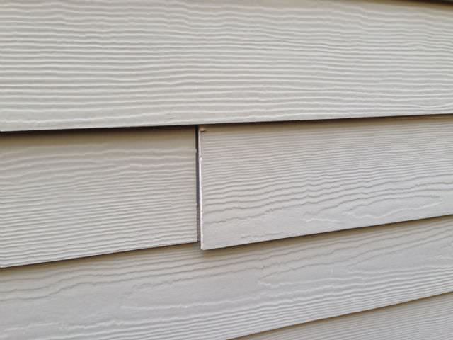

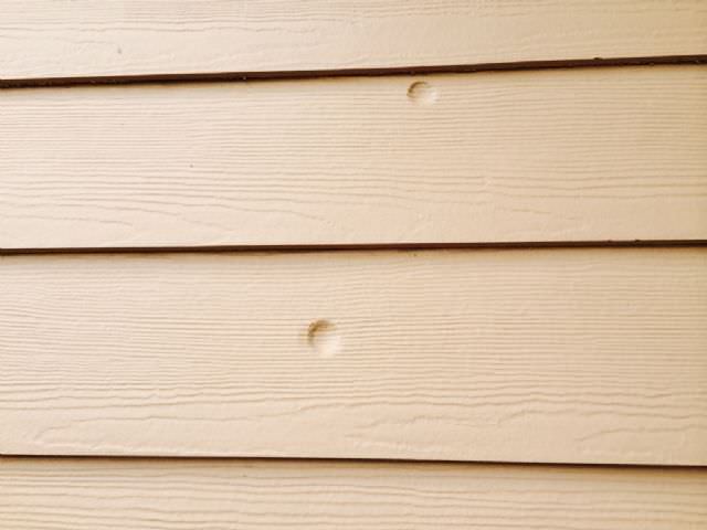

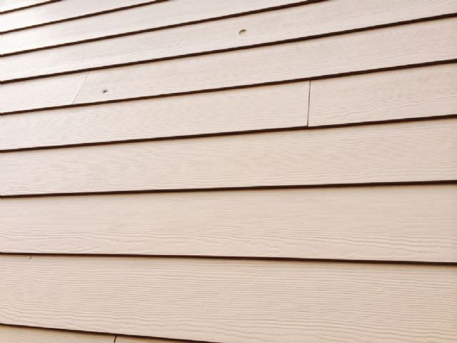

janineanne Posted April 7, 2014 Report Posted April 7, 2014 Hi all, I know this is a somewhat old topic but this looked like a good place to post my question as there are knowledgeable people in this thread. I own a 10 year old home near Portland, Oregon. For those who are local, it was built by Arbor; for those who aren't, think sleazy mass market builder who gets sued a lot. We are going to be painting the house ourselves this summer, and as such I've been taking a closer look at it than I usually do. We have Hardiplank and overall it's in pretty good condition, except for the large gaps where the caulk disappeared a long time ago. We had no idea you were supposed to re-caulk a two story house on a regular basis. A few of the boards have cupped out slightly on the ends, but nothing major. However, there's one section of siding, on the west side of the house, where some of the pieces appear to have slipped. Representative pictures below. They aren't loose, in fact they don't move at all when I try to wiggle them. One of them has a visible nail hole with no nail in it (not torn out). Can anyone please tell me: - what the heck happened here? (a shoddy installation job is a given, it's Arbor) - how do we fix this with a minimum of removing and replacing? - are there any good homeowner references out there on how to work with this stuff? I presume we probably would not understand the official installation instructions nor have the correct tools to follow them. - is there any point in contacting James Hardie after 10 years? We are not the original owners of the house and have no idea what the warranty is on this stuff. Further, since we are going to have to touch every single joint on the house, is it worth our while to try to install flashing under the joints? Is this a homeowner-level task? Smearing on caulk sounds easier but I don't want to be up there again in a couple of years (did I mention it's a two story house? Thanks in advance to anyone who can offer advice or pointers to other information. This task is completely new to us so we have a *lot* to learn. Click to Enlarge 44.12 KB Click to Enlarge 43.77 KB
mark parlee Posted April 7, 2014 Report Posted April 7, 2014 janineanne This is an old thread but still the problems with fiber cement siding persist You have a lot of work ahead of you. There have been a lot of recommendations over the years that have proved to less than satisfactory for the discerning home owner. Caulking the joints has proven to be a poor detail in many if not all of the installations I review. This is due to the performance characteristics of the sealant. You have to take into account the dynamic movement of the joint that you are attempting to seal. This type of narrow joint will not work, it can?t. sure some will say ?hey I have seen it work? my statement that it will not, cannot work is a generally true statement; there are some places where this joint will not come loose but that is the exception for some reason. You will have a 90% or more sealant failure at these types of narrow joints. Here is the skinny on the joint failure: Sealant let?s take Vulkem for example, a very popular and widely used sealant. http://www.cadeco.com/productfiles/Tremco-Vulkem116.pdf Joint design: Joint width should be 4 times anticipated movement. But not less than ?? wide. Movement should not exceed 25% of the minimum joint width. For joints ?? to ?? wide. The width to depth ratio should be equal. Minimum joint size is to ?? x ?? Surface Preparation: For good adhesion, the joint must be sound, clean and dry. (This just about doesn?t happen) Then we go to the So we have a joint between the panels that is aprox 1/8? wide and the panel easily moves 1/8? . Now we have 100% joint movement and adhesion is less that desirable. The joint fails. The joint collects water and the moisture saturates into the panel at the ends this moisture collection at the joint is due to the small size of the joint and surface tension of the water; it just hangs around until the panel absorbs it. In the colder season the ends of those panels are damp to wet and we go into freezing weather. When the moisture freezes it expands 9% and over time you get spalling at the joints. So far I have only addressed the sealant issue at the joints. Fiber cement is very fragile. The nails that are often used are small headed and overdriven with an airnailer. Over time with wind it can cause the siding to mildly vibrate and the siding to fracture at some off those nails, this will allow the siding to drop slightly putting additional stress on the adjacent fasteners and more time and more wind and the siding looks like what you have. I used to sing the praise of a well installed fiber cement siding job. Not so much anymore as I am called to investigate so many problems on this material. I realize you came here for advice on what to do to save this stuff. Without knowing your abilities that is tough to know what will work for you. I do help people out from time to time via pictures through email and phone calls. Send me a direct email if you wish. Here are some pictures of the stuff 200? from the T. It is very fragile material. Click to Enlarge 41.53 KB Click to Enlarge 42.41 KB Click to Enlarge 37.61 KB
kurt Posted April 7, 2014 Report Posted April 7, 2014 Janineanne.... There is a tendency to complicate and obfuscate what are, at base, very simple carpentry tasks. That seems to be happening here. You may have a mess on your hands, but I doubt it. It looks manageable. Do not be afraid of the installation instructions; they're actually relatively simple. The skill set for installation is also relatively simple. I have taught complete amateurs with no experience whatsoever how to install cement siding perfectly. It's not hard to carry, set up, or install. I am mildly shocked that some make it out to be so complicated. Caulking is not complicated either. There's some science and art, but I assure you, you can handle it with a little patience and persistence. Better yet, don't caulk; use flashing strips that Hardi recommends you use. The flashing strips work fine. It's not particularly fragile; I don't know why Mark is saying it is. There are procedures for handling it, that if followed, work. It's not like the stuff has a molecular breakdown if you sneeze; you have to work at it to screw it up. (FTR, I see morons working really hard to screw it up, and they succeed. They are the same morons that don't ever read instructions, don't know how to nail, and dismiss any idea that's not already in their head.) You can handle it. It's only a house. Folks fix them all the time. You can too. You do stuff every day that's ten times more complicated than installing siding. If you really want to fix your house, you will find your way. You can do it. Take a few more pictures, post them, let's see what's going on.
