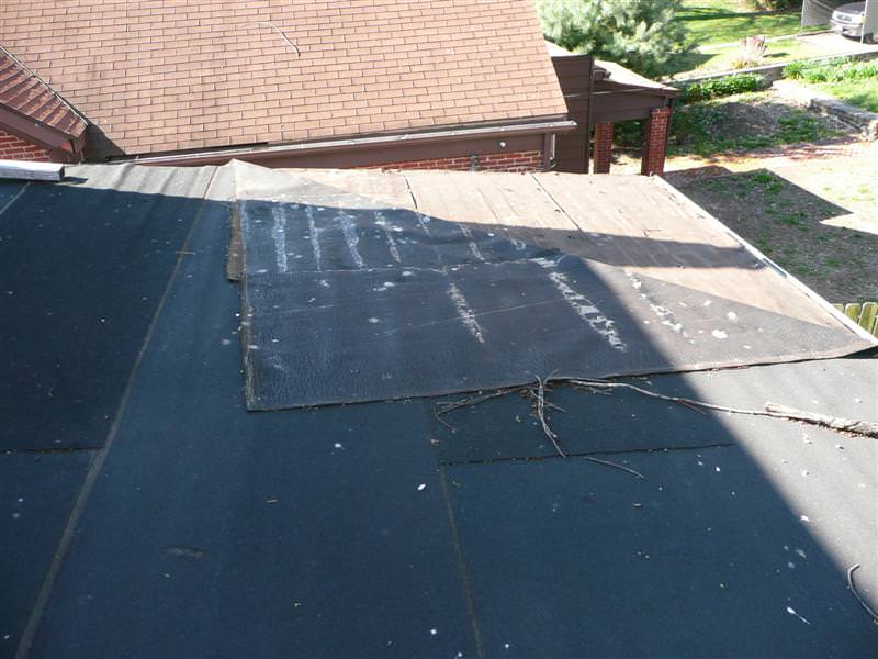

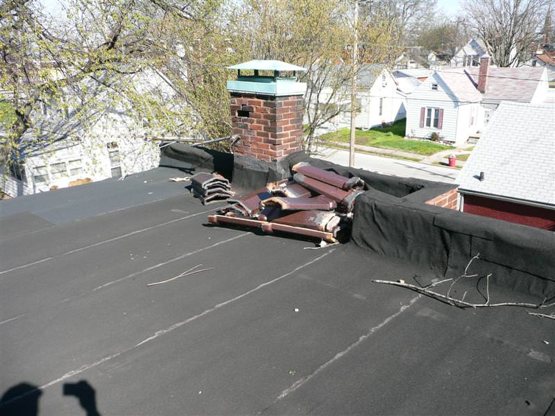

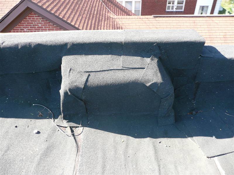

Mark P Posted April 17, 2008 Report Posted April 17, 2008 I am looking for the instillation instruction for Rolled Asphalt. I am especially interested on how it should be installed when there are parapets on the house. I understand the covering will trap moisture inside the bricks causing their decay, but how should it be done. Are termination bars used in this case? Iââ¬â¢ve already told the buyer the roof was installed unprofessionally and in my opinion will not last very long; that there are repairs that need to be done now. But I want to learn some more on how this should be installed on a house like this. This house is a complete mess from head to toe. Download Attachment: 1.jpg 94.15 KB Download Attachment: 2.jpg 107.01 KB Download Attachment: 3.jpg 92.98 KB Download Attachment: 4.jpg 119.18 KB Download Attachment: 5.jpg 81.85 KB
kurt Posted April 17, 2008 Report Posted April 17, 2008 Are you sure that's rolled asphalt? It looks like it could be granulated mod bit(?). Rolled asphalt won't "do" a lot of the stuff the installer is making this stuff do. "Yes" to termination bars/counterflashing bars. "No" to wrapping it up over the parapet. Where's the coping? Baseline, tear it all off and start over.
Mark P Posted April 17, 2008 Author Report Posted April 17, 2008 Thanks Kurt, It is granulated modified bitumen, I should have know better, I make that mistake too often because I see very few of these. I'm going to swing back by this evening to take a second look at a few things. This is turning into the report from hell, a real monster of a house. I'm also sure it is haunted, but I'm going to let that be a surprise to the little lady buying the home. So help me out here - so I don't make the same error again how exactely do I tell the difference between rolled asphalt and granulated modified bitumen?
BornaRoofer Posted April 17, 2008 Report Posted April 17, 2008 The roof looks like its unsaveable. I couldn't list all the things I see wrong. Possibly reflashing and proper metal details throughout would give it a few years. Your supposed to go over the parapet and install a coping. Bar is used when your terminating to a wall you cant go over the top of or a wall end. I recommend surface or reglet metal not bar though. The field sheet goes 4" up past the cant then a separate flashing up and over the wall and 4" onto the field. You can tell if its a mod bit by the texture of the bitumen. Its rubbery and somewhat elastic if you push or pull on a piece.

Jim Katen Posted April 18, 2008 Report Posted April 18, 2008 Put me in Kurt's camp regarding the don't-run-the-membrane-up-the-parapet issue. If you do, you're putting a vapor barrier on one side of the brick and leaving the other open to the rain, sun, snow, whatever. The brick doesn't seem to like that. Your picture #4 shows the mortar decay on the outside of the parapet. As for the rest of the roof, it's a disaster. I know some roofers who might be capable of saving it, but none of them would do it. Who needs to take on the liability of a job that was done by morons? - Jim Katen, Oregon
