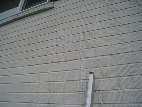

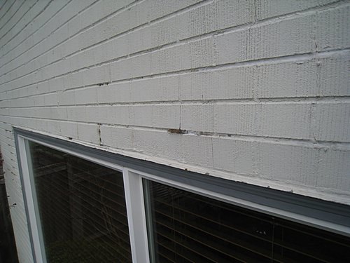

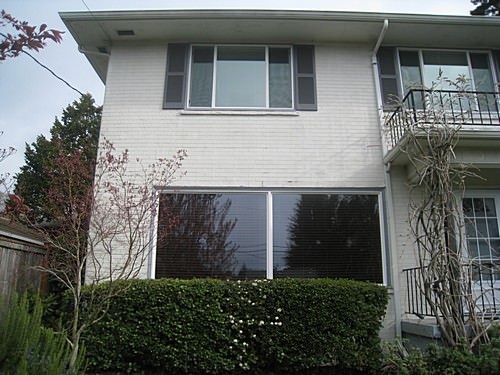

Chris Bernhardt Posted April 10, 2008 Report Share Posted April 10, 2008 I haven't seen this before. At first my pea brain thought it was brick. Then I though it was a brick veneer stucco'd onto block. Now, I am thinking that it has to be brick veneer stucco'd on to a wood sheathed and framed wall. Can anyone confirm for me that it is likely a brick veneer stucco'd onto wood sheathing? Image Insert: 74.72 KB Image Insert: 84.64 KB Image Insert: 76.49 KB It's hard to see from the pictures the area between the two windows were buckled and bulging. There are two larger cracks that run from the corners of the upper window down to the corners of the lower window with everything messed up in between. Chris, Oregon Link to comment Share on other sites More sharing options...
Scottpat Posted April 10, 2008 Report Share Posted April 10, 2008 OK, I'm confused.. Granted it doesn't take much to accomplish that. Are you saying that this is a brick pattern in stucco on a house with a wood substrate? or Are you saying that this is a brick pattern with a stucco like material on wood then attached to the house? or Are you saying that this is a stucco clad home that has had a brick veneer placed over the stucco? or Heck, I have run out of options! I have seen EIFS with a brick pattern in it. Looks like real brick until you thump it. Link to comment Share on other sites More sharing options...
Chris Bernhardt Posted April 11, 2008 Author Report Share Posted April 11, 2008 It looked like individual brick faces. But jeesh that would be a lot of work to get them on straight. I could see at the corners of the building where their thickness was about 3/8" of an inch and the way things were buckling on the front I couldn't imagine them being full sized bricks. The thickness of the exterior walls was on the order of them being 2"x4" framed. IR wasn't much help as it was showing the walls being cooler then I would have expected but warmer above windows. I could faintly make out some stud locations but they could as well as been furring. If it is some kind of masonry unit its less than 8" deep, in fact it would have to have been closer to 4" to make sense. Image Insert: 73.56 KB Chris, Oregon Link to comment Share on other sites More sharing options...
davidlord Posted April 11, 2008 Report Share Posted April 11, 2008 It looks like stucco with a brick pattern cut into it. Link to comment Share on other sites More sharing options...
Bill Kibbel Posted April 11, 2008 Report Share Posted April 11, 2008 Looks like brickface. It was wildly popular here from the 40s through the mid 70s. Some old towns here have 60% of the historic buildings covered with it. Here's the process: www.brickface.com/product_gallery_brickface.html Link to comment Share on other sites More sharing options...
johnmcda Posted April 11, 2008 Report Share Posted April 11, 2008 Originally posted by inspecthistoric Looks like brickface. It was wildly popular here from the 40s through the mid 70s. Some old towns here have 60% of the historic buildings covered with it. Here's the process: www.brickface.com/product_gallery_brickface.html Could be an EFIS product such as http://www.stocorp.com/allweb.nsf/creativbrick Could also be a cement fiberboard panel product such as http://www.nichiha.com/prod_nano.htm Link to comment Share on other sites More sharing options...
Brian G Posted April 11, 2008 Report Share Posted April 11, 2008 Originally posted by inspecthistoric Looks like brickface. Who you calling brickface? [:-irked][] Brian G. "Kibbel" Is Dutch for "He Who Knows Much Obscure Stuff" [^] Link to comment Share on other sites More sharing options...
