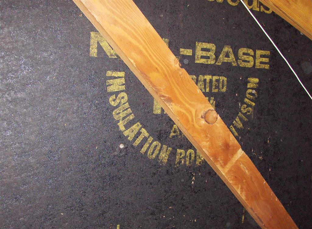

John Dirks Jr Posted April 7, 2008 Report Share Posted April 7, 2008 What do you call this material and is it suitable as a fire break between the garage and house attics? Image Insert: 179.09 KB Link to comment Share on other sites More sharing options...
hausdok Posted April 7, 2008 Report Share Posted April 7, 2008 Sure looks like some kind of Nail-Base Fire Rated Insulation Board. I suggest Google - it's a wonderful thing. OT - OF!!! M. Link to comment Share on other sites More sharing options...
John Dirks Jr Posted April 13, 2008 Author Report Share Posted April 13, 2008 Originally posted by hausdok Sure looks like some kind of Nail-Base Fire Rated Insulation Board. I suggest Google - it's a wonderful thing. OT - OF!!! M. Who needs google when we have you Mike? Link to comment Share on other sites More sharing options...
Bill Kibbel Posted April 13, 2008 Report Share Posted April 13, 2008 It's asphalt impregnated fiber-board (like Homasote). I doubt it says "Fire Rated". Link to comment Share on other sites More sharing options...
msteger Posted May 8, 2008 Report Share Posted May 8, 2008 Originally posted by AHI What do you call this material and is it suitable as a fire break between the garage and house attics? Image Insert: 179.09 KB If it's what I think it is, it will go up like a newspaper when ignited. I would not classify it as fire rated unless it says it is. Link to comment Share on other sites More sharing options...
jon_ran Posted May 9, 2008 Report Share Posted May 9, 2008 Could you see under that 1X4? It is either "something" rated or "something" impregnated. Link to comment Share on other sites More sharing options...
John Dirks Jr Posted May 9, 2008 Author Report Share Posted May 9, 2008 Originally posted by jon_ran Could you see under that 1X4? It is either "something" rated or "something" impregnated. What you see in the picture is the best shot, anywhere in the attic, to find writing that would identify the material. I could not see under the 1x4. Link to comment Share on other sites More sharing options...
