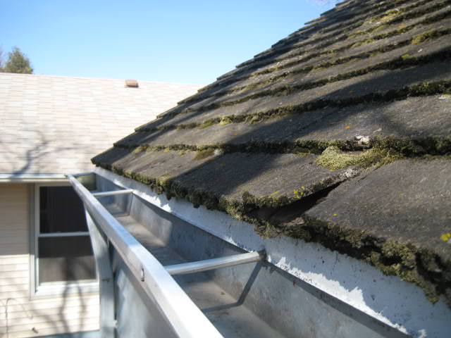

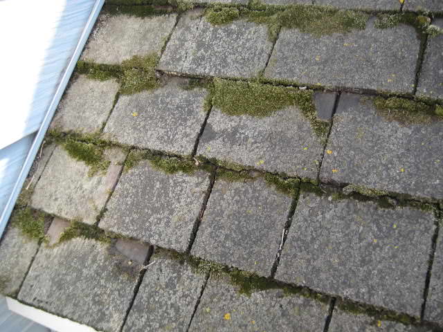

jodil Posted April 4, 2008 Report Posted April 4, 2008 Hi, I read everything on this forum in regards to shake roofs, and know alot more now. However, I'd like you alls opinion about this one. This roof is only 4 years old. It has ALOT of moss (large pieces of moss growing underneath top layer has popped off some shakes), there are several shakes in various areas that have already been replaced, and I could see felt in various areas. Image Insert: 62.52 KB Image Insert: 59.75 KB The realtor asked me when she showed up if the roof is "serviceable?" I told her any roof is "serviceable." (just a matter of how much service one is willing to pay for?) Anyways, is it typical for such a newer roof to have so much moss? (There is a huge oak tree in the front that completely blocks the front from any sunlight.) What is your opinion of the roof in general? Thank you!
hausdok Posted April 4, 2008 Report Posted April 4, 2008 Hi Jodi, That's hard to say. If I had to rely on the first photo, I'd say there's no way that cover is only 4 years old and it's rotting. However, it doesn't look nearly as bad in the second photo; although it's still hard to say, since it's too far away and it's not a very good angle. Was the cover over a solid deck or skip sheathing? Were there felts interwoven into the shakes that you could see from the attic side? Is it possible that only one slope was redone and the other is older and rotten? Are these certa shakes with any kind of warranty? If you're going to take photos and ask folks to try and gauge wear, the best thing to do is to take some establishing shots that show the perimeter of the house and then the entire roof and then smaller areas, moving from the general toward the spefic, taking several shots as you move in. You also need to take shots from several angles and even straight on so that we can get a better view of the shakes. ONE TEAM - ONE FIGHT!!! Mike

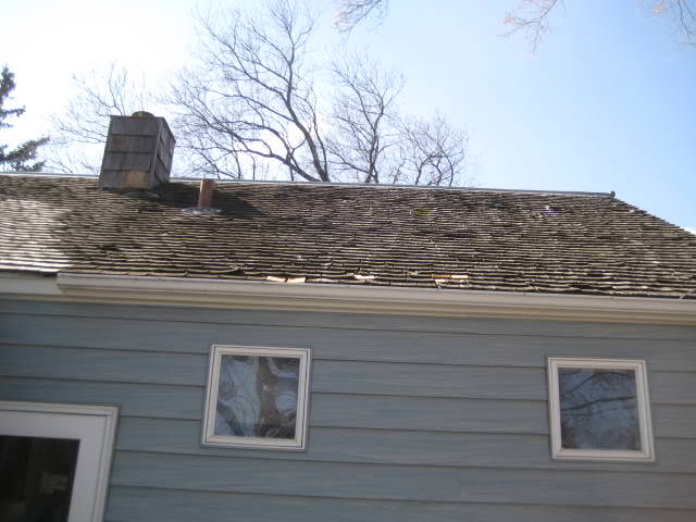

jodil Posted April 4, 2008 Author Report Posted April 4, 2008 I dont know if this photo is any better at showing you what you need to know. Image Insert: 89.66 KB The attic was partially finished off (inside of attic had blanket insulation covering everything) which was just installed. According to the home owner (and the Realtor whom has sold and listed this house several times over the last 10 years) it was completley redone four years ago. I didnt think to ask him if it was under warranty. The front side (as seen in the above pic) has the most moss (due to the huge tree in front) but appears in better condition even with the moss than the back side. I worry about it, since the seller is a "handyman" and has done a crappy job at other repairs (cutting a doorway through the foundation to make a storage room where the cistern used to be with nothing re-enforcing the opening.) thank you

hausdok Posted April 4, 2008 Report Posted April 4, 2008 Hi, From that angle, they look like wood shingles where the maintenance has been neglected. A proper HVLP cleaning and oiling will probably bring it back but if it's over solid decking it's never going to be able to breath properly and I doubt that it will last nearly as long as the roofer said it would. By the way, the reason that I suspect solid decking is the drip edge at the eaves. With shakes applied over skip, there is normally an inch or two of overhang before that first piece of skip and no reason to use a drip unless you're trying to protect the edge of an OSB or plywood deck. That moss is quite literally eating those shakes, by the way. ONE TEAM - ONE FIGHT!!! Mike

jodil Posted April 4, 2008 Author Report Posted April 4, 2008 Since there is most likely OSB or a solid form of decking underneath, combined with no ventilation in the attic and blanket insulation installed on the back side of the decking, would you say that all of these factors are contributing to this premature deterioration?
hausdok Posted April 4, 2008 Report Posted April 4, 2008 Yep, Unless it's in a very dry climate, a shake roof or cedar shingle roof really needs to be installed over skip, battens, or some type of cedar breather material. Go here and download the full roof manual. OT - OF!!! M.

drcr Posted April 5, 2008 Report Posted April 5, 2008 Good advice there. I would add that those wood shingles may be white cedar instead of red cedar. In which case they will deteriorate much faster in those conditions. You might be able to tell by cutting a sliver off one of the shingles.
