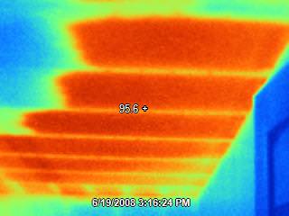

Missing insulation in an unaccessible attic.

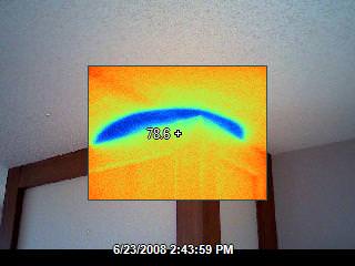

Active roof leak around chimney (verified with contact moisture meter)

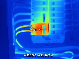

Overheated Breaker

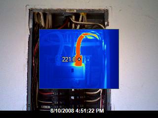

Overheated Service Wiring

Roof leak at bottom of valley (verified with contact moisture meter)

How am I doing on my analysis so far Terry?
