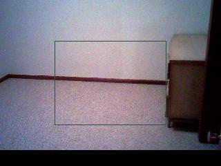

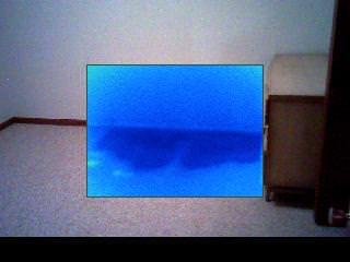

qhinspect Posted August 13, 2008 Report Posted August 13, 2008 Originally posted by PBusch I'm just trying to foresee certain types of situations that may arise. Just did an inspection where water seepage was noticed with the IR camera. No visual signs of water seepage or any indication that water seepage would or had occur. Yet the IR just saved me a headache when the next rain comes. Just a note, it has been a week since we had rain. What I was seeing. Image Insert: 10.98 KB What the IR showed me. Image Insert: 11.07 KB
Bain Posted August 13, 2008 Report Posted August 13, 2008 Those last photos are nifty. You said no rain during the past week, but there had to be moisture beneath the carpet for the IR to display the dark blue seepage, right?
randynavarro Posted August 14, 2008 Report Posted August 14, 2008 How do you know it was moisture vs. an air leak?
qhinspect Posted August 14, 2008 Report Posted August 14, 2008 Originally posted by randynavarro How do you know it was moisture vs. an air leak? I felt the moisture plus the moisture meter pegged off when testing the wood strip holding the carpeting in place at that location but no moisture at any other location against the wall.
hausdok Posted August 14, 2008 Report Posted August 14, 2008 Originally posted by qhinspect Originally posted by randynavarro How do you know it was moisture vs. an air leak? I felt the moisture plus the moisture meter pegged off when testing the wood strip holding the carpeting in place at that location but no moisture at any other location against the wall. So, if you routinely check the base of all of your walls, you probably would have found it anyway without the IR camera using the moisture meter; no? ONE TEAM - ONE FIGHT!!! Mike
qhinspect Posted August 14, 2008 Report Posted August 14, 2008 Originally posted by hausdok Originally posted by qhinspect Originally posted by randynavarro How do you know it was moisture vs. an air leak? I felt the moisture plus the moisture meter pegged off when testing the wood strip holding the carpeting in place at that location but no moisture at any other location against the wall. So, if you routinely check the base of all of your walls, you probably would have found it anyway without the IR camera using the moisture meter; no? ONE TEAM - ONE FIGHT!!! Mike To answer your question/attack. I seen the dark area with the IR camera, I reached down and felt moisture with my hand. Anytime I think there is moisture from a condensation problem or water leaks, I use my moisture meter to check that area (It also gives my clients something else to see if for some reason the seller argues the point). If that area does show high moisture, I check the surrounding areas with my moisture meter for comparison. I look at all information that is available to me to help determine the possible reason for that moisture to be there and come to a conclusion. In this case, there was not enough information to tell me what the likely problem is. When it comes to the IR camera, I scan the basement and actually found two leaks on the carpeting. The first is from a leaky clean out on the waste pipe where I had to take a cover off to see where it was leaking from and the second is what I wrote above. It was likely that I would have seen the leaky waste pipe but unlikely that I would have seen the high moisture at the picture given above. Since I and my clients were already in that room looking at the walls, outlet and other items, I strongly feel that I would not have seen the problem shown in the picture above. So to answer your question directly; no, I do not routinely check the base of all the walls and unlikely that I would have discovered the high moisture at this location. When I see an area where moisture is likely or is present, I check that area plus the surrounding area to try to get a better understanding of the situation.
